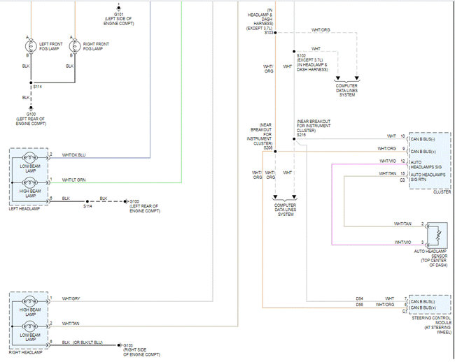

I just changed the fuel injectors and put in new spark plugs yesterday. Today, the drivers side headlight keeps turning on and off when the car is off and there is a loud clicking in the engine area.. anyone know if maybe I crossed something?

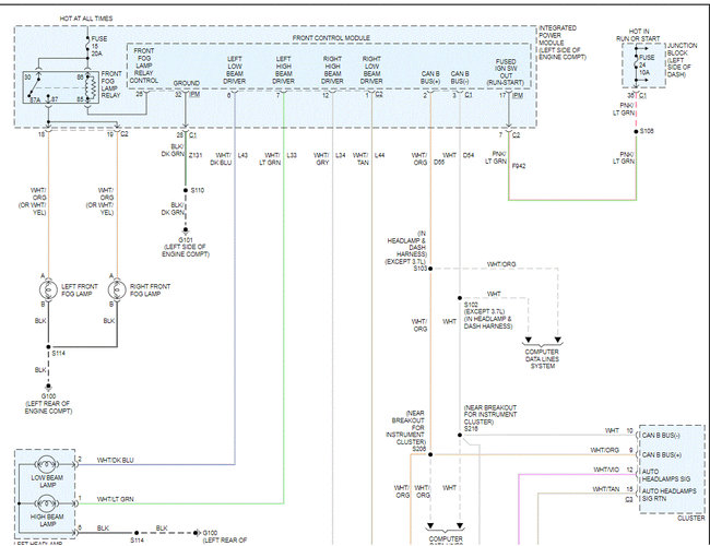

We need to determine where the sound is coming from. This vehicle has an integrated power control module. (TIPM). Something could have a bad connection there.
I attached the entire wiring schematic below for the headlamps. Take a look through it. I don't see how it is related to the other work you've done, but anything is possible. I had to cut the pic in half to make it readable, but I did overlap them so you could follow them.
See if you can tell if the sound is coming from the TIPM, which is under the hood on the left side of the engine compartment.
