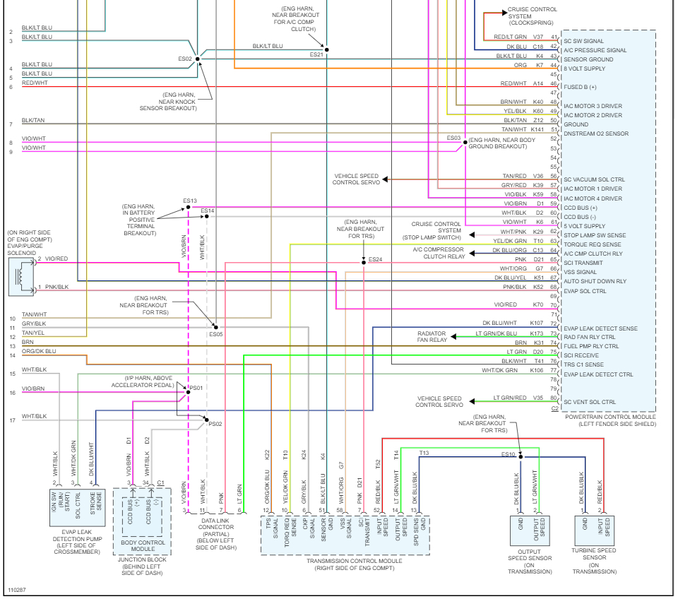

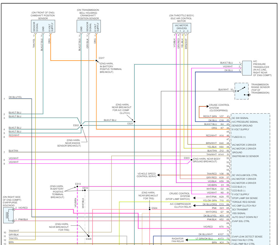

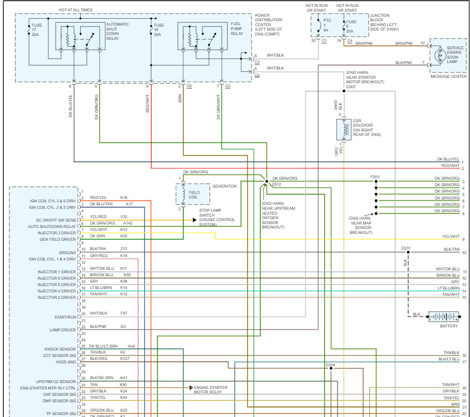

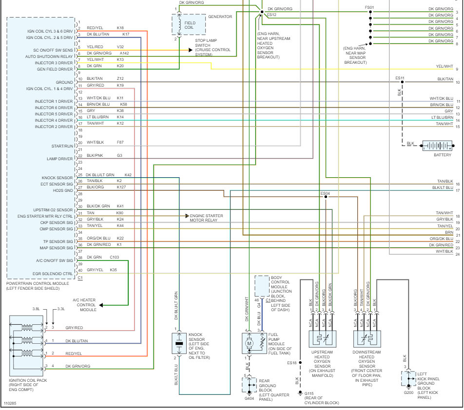

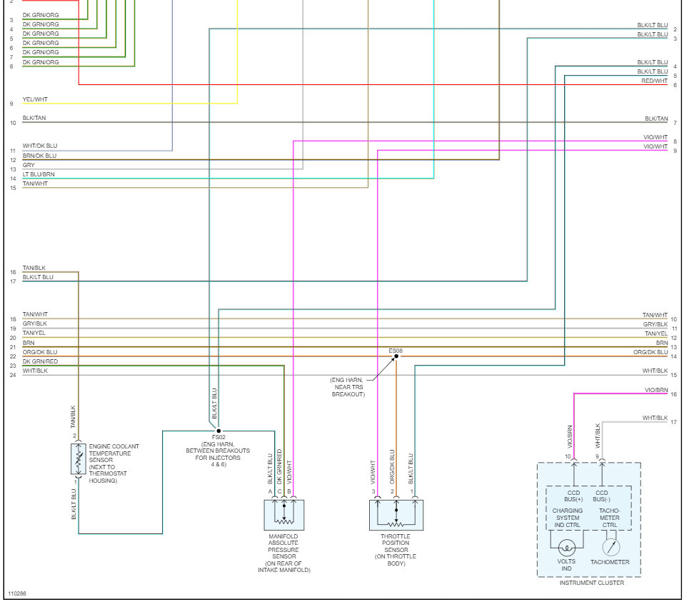

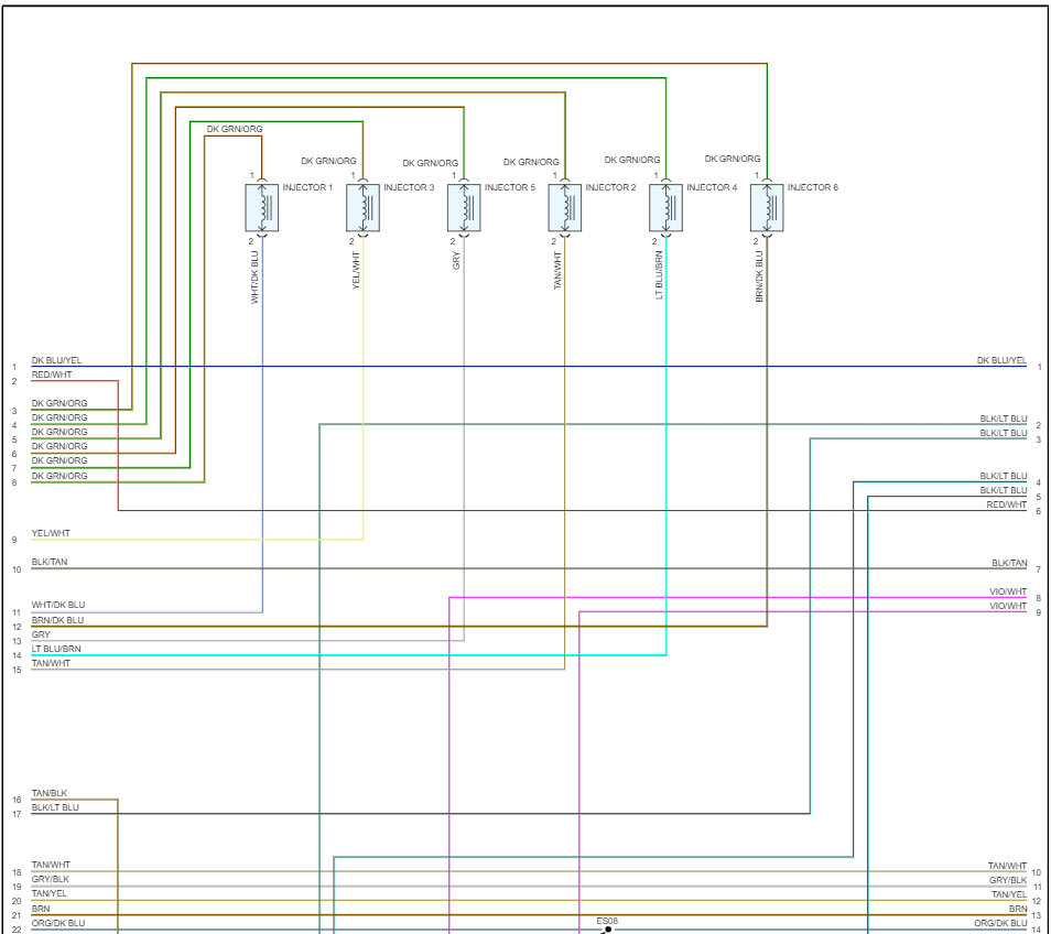

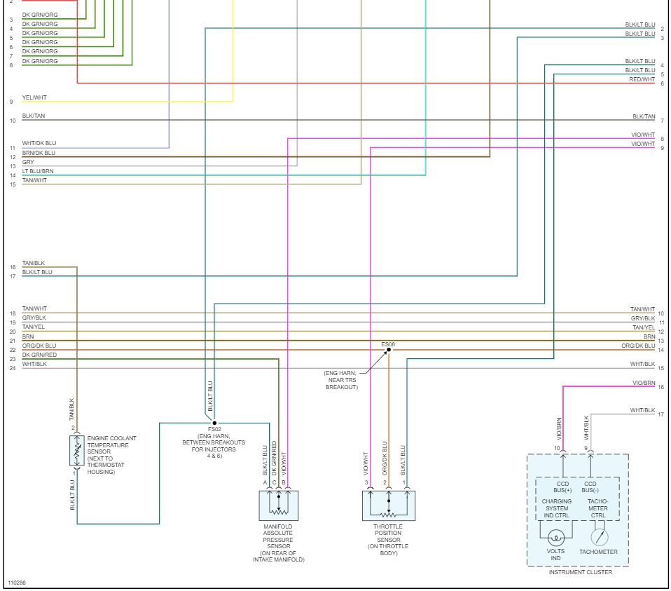

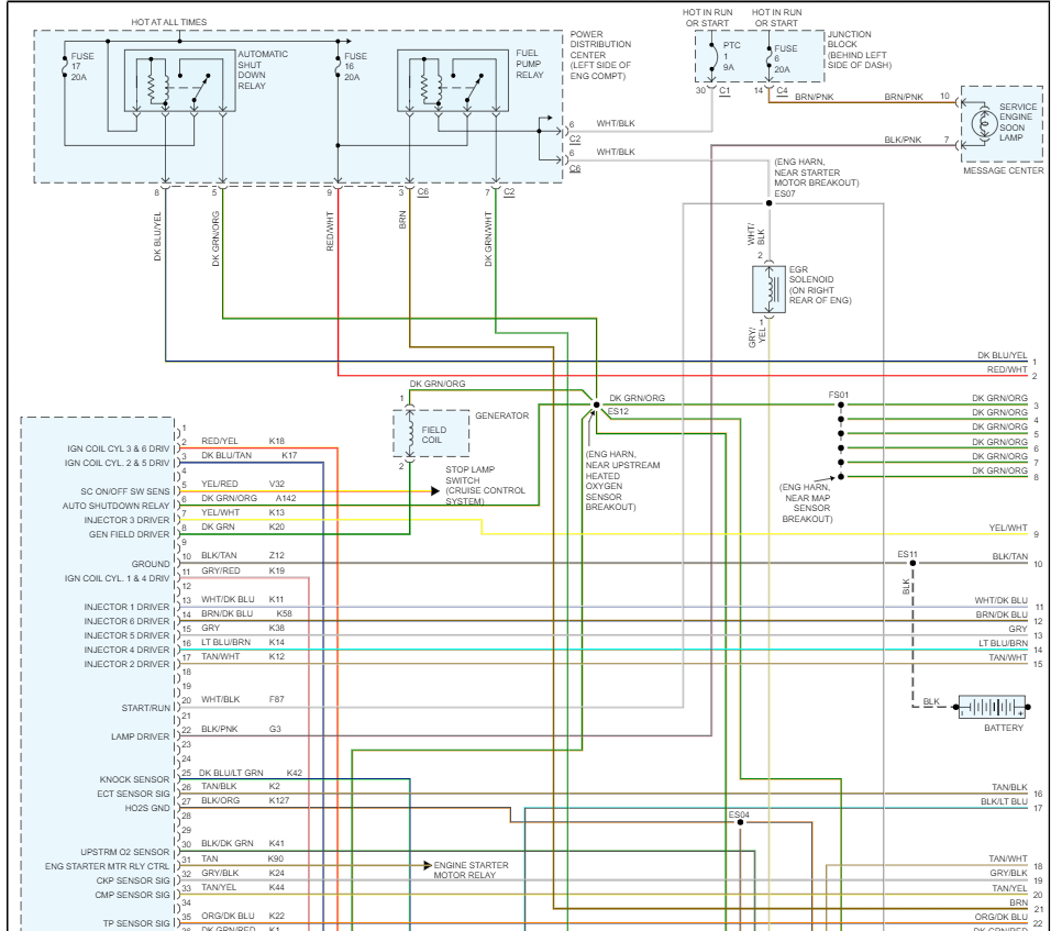

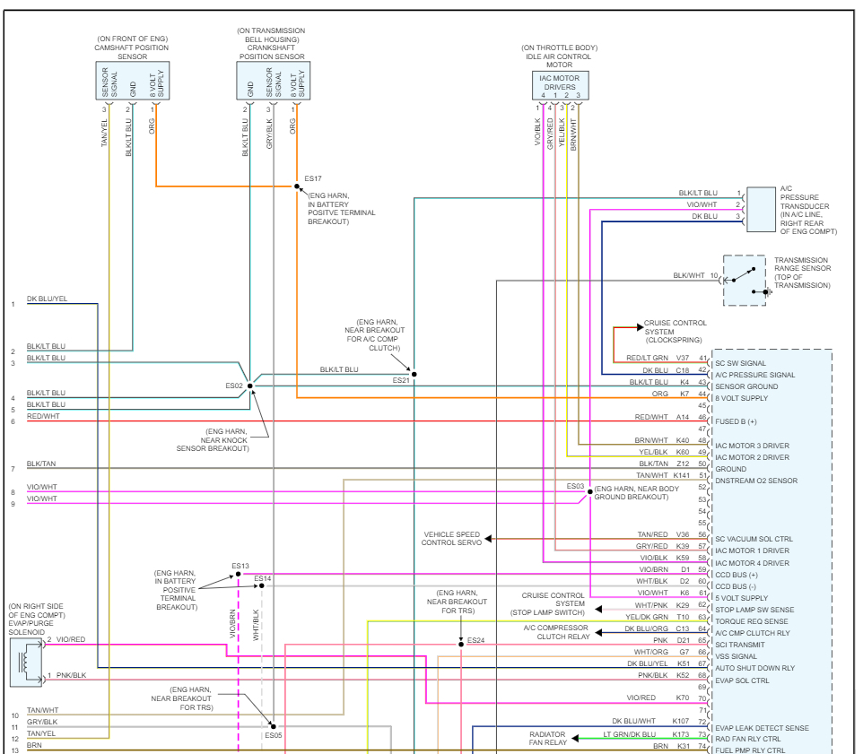

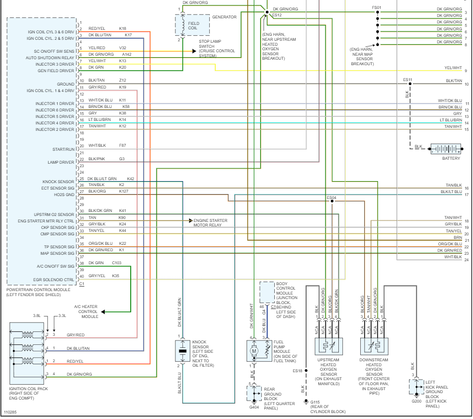

Will single start in either park or neutral. Never had a chip on keys, security is in the PCM, if any. No corrosion found anywhere. Would like to find a schematic of pins for the PCM for further testing. Will test and verify CMP and CKP; will also perform a voltage drop test and post my results.
Jul 22, 2023 at 9:50 AM
  • 55,456 POSTS
Sure, here are the PCM wiring diagrams and a guide to help you with the testing.
Check out the images (below). Please let us know how it goes.
