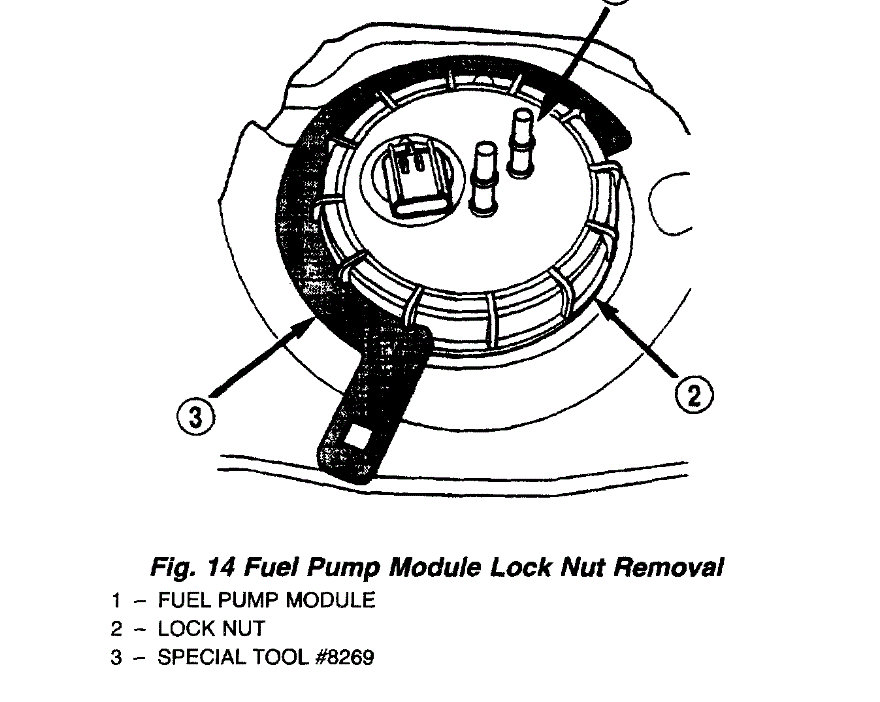

On top of the fuel pump where the hose connects to the fuel pump the little file that the hose connects to broke off. Is there a way to fix it?

I attached a pic below. Are you referring to one of the connectors in the pic? If you are, that can't be repaired. They are under pressure and there really isn't a way to fix it.
Let me know if that is what you are referring to.
See pic below.

Yes, I am referring to this, now it cranks but won't start.

If it is disconnected, it won't get the fuel to run. I suspect you will need to replace the fuel pump module assembly. Or have you already done that?
