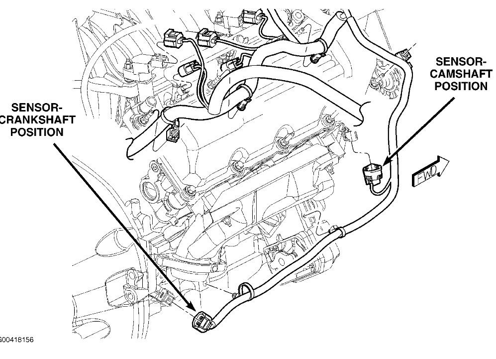

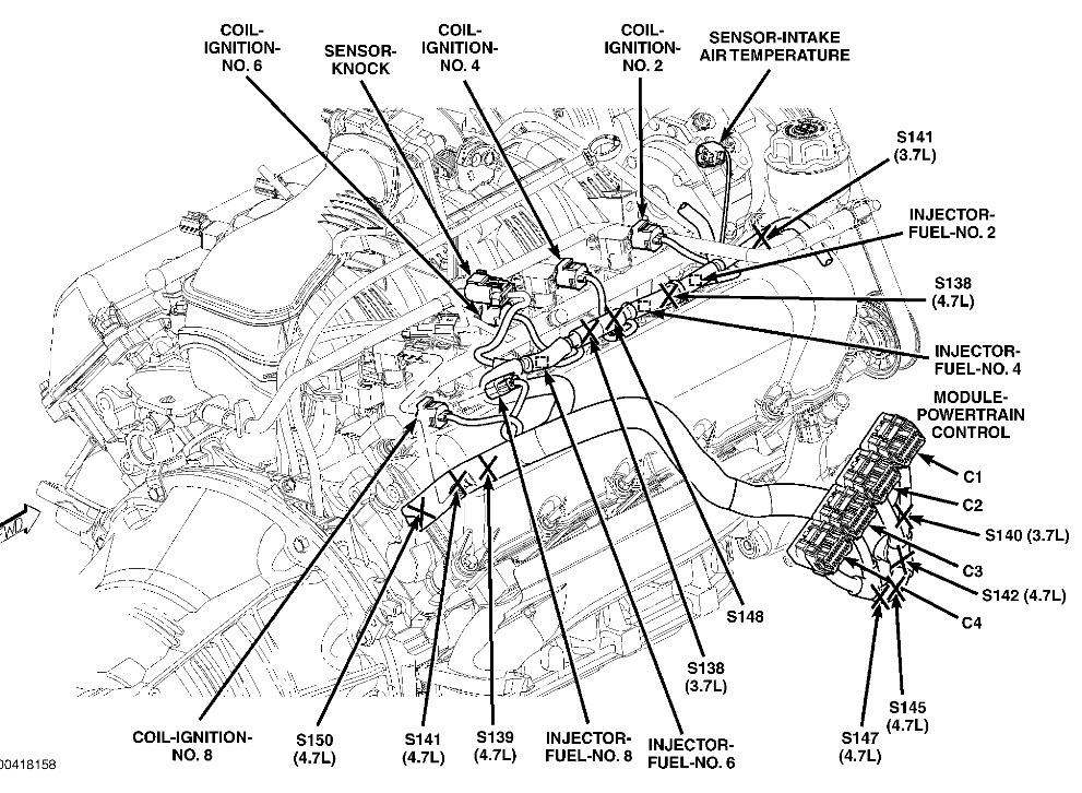

on the right side wiring harness, there is a wire and connecter after the connector to the cam sensor, need to find where this last connecter goes
2006 JEEP COMMANDER
120,000 MILES • 4.7L • V8 • 4WD • AUTOMATIC
JOHNINVA
  • 12 POSTS
on the front bottom of pass. side cylinder head is the cam sensor and connecter, from there, there is another longer wire with connecter. does this go across, under the crank pulley....to where? putting engine back together after head job, and I cant remember...(yes i know i shoulda wrote it down) where this last connecter goes...I'm hoping its important enough to keep the engine from running.....maybe.... Thanks for any help!
Jul 24, 2015 at 12:36 PM
HMAC300
  • 48,601 POSTS
see pics may be a knock sensor
Jul 24, 2015 at 4:13 PM
JOHNINVA
  • 12 POSTS
Awesome, that's it. THANK YOU. I was looking toward the front of the engine. Got her started running but now no oil getting up to the valve covers and valvetrain. Aargh
