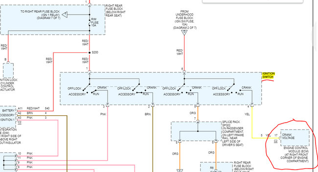

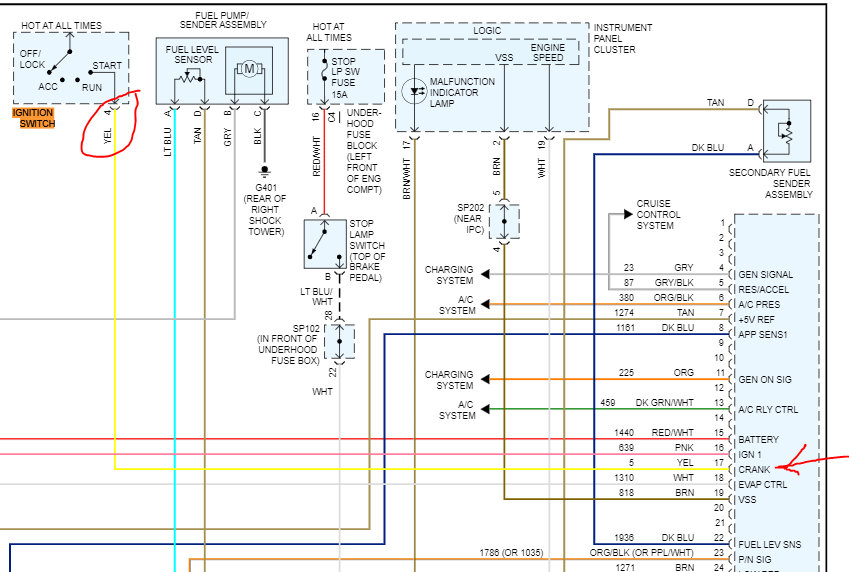

On the lock cylinder which wires which wires are the resistor wires?
13,000 MILES
2/SAINT
I was told they are you yellow and black, I don’t see black.
Aug 23, 2022 at 7:16 AM
  • 110,251 POSTS
Are you referring to the ignition switch? If so, the yellow wire is the crank signal and runs to the ECM.

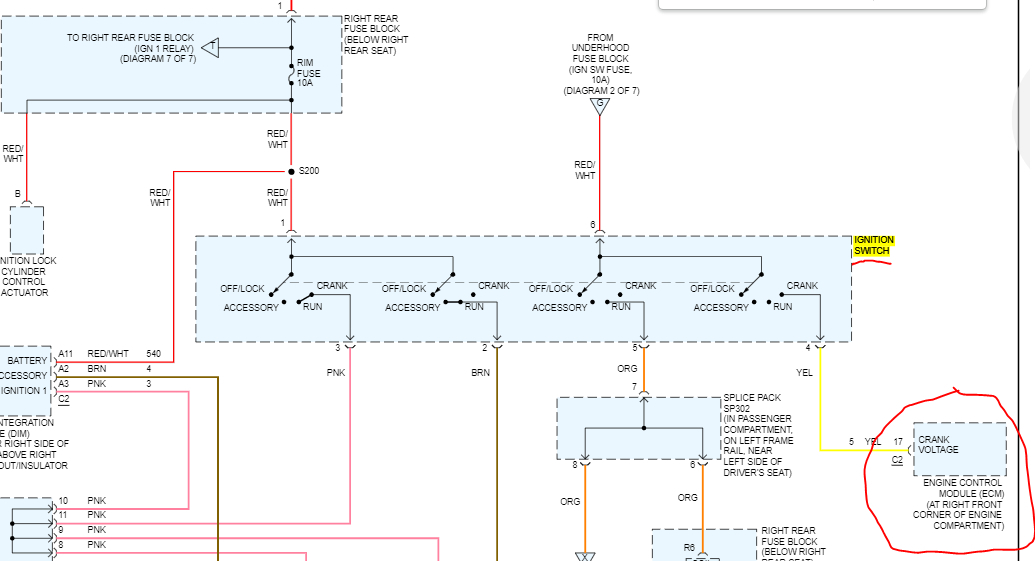

I attached two different wiring schematics below. Pic 1 shows the yellow wire. Pic 2 is from the power distribution schematic and shows all the wires related. I'm not seeing a black wire. Also, I'm not sure what you mean when you say resister wire, I'm not sure what you are referring to.
Take a look at the pics below and let me know if they help.
