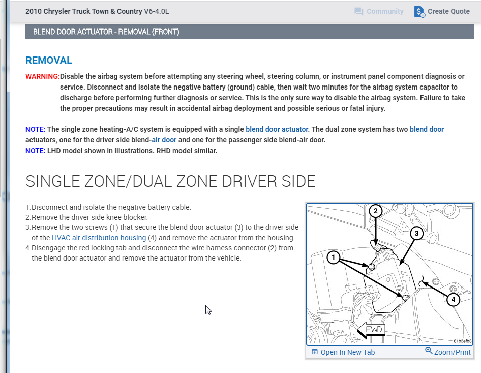

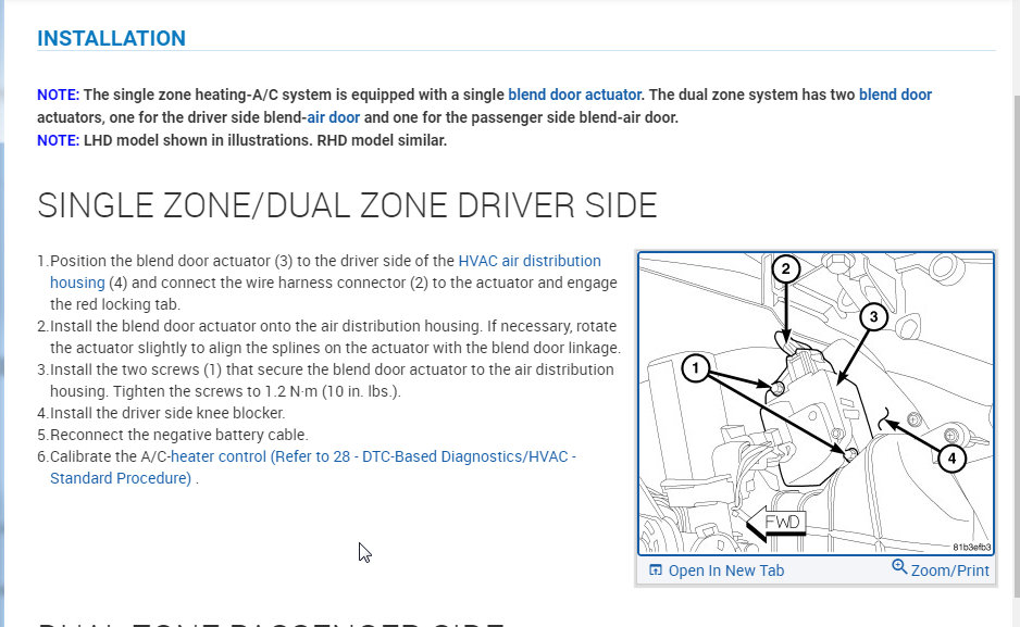

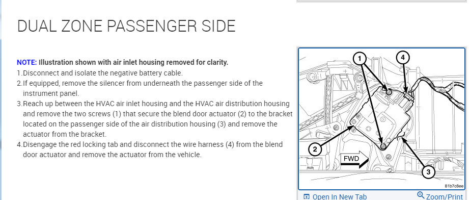

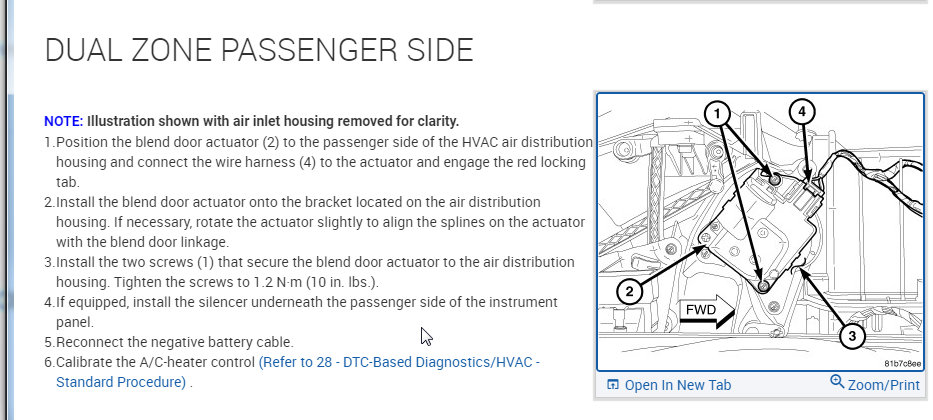

A/C and heater air blend actuator clicking.
Sep 10, 2020 at 5:19 AM
Experienced Mechanic
18,907 POSTS
I attached the process for the front blend door actuator. This is not uncommon when the plastic gear inside of it strips and it starts clicking.
Let us know if you have more questions. Thanks
