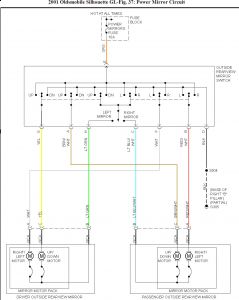

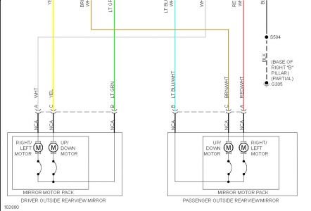

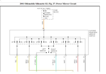

My mirror was torn off, it has a 4prong connector and then 2 single seperate wires coming from the door. My problem is that all the mirrors I see for sale are 6 prong connectors but 5 wire inside it. Can you give me a wiring diagram or tell me were to find one so I can hook up a new mirror?Or do you know where I can find an exact fit?10[img:e5c555a691]http://www.2carpros.com/forum/automotive_pictures/493390_CIMG0074_1.jpg[/img:e5c555a691]

https://images.2carpros.com/forum/automotive_pictures/30961_zm1b_1.jpg
https://images.2carpros.com/forum/automotive_pictures/30961_zm1a_3.jpg
https://images.2carpros.com/forum/automotive_pictures/30961_zm1_2.jpg
