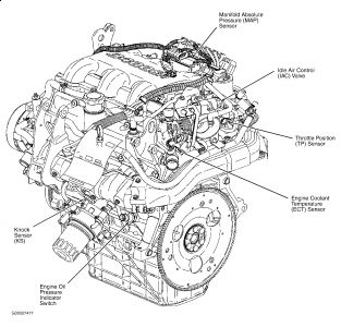

Engine temperature Indicator (needle) does not work, The car is ok, the vent that cools the car is working, everything seems to be working fine but the needle does not work.

Maybe faulty Engine Coolant Sensor
https://images.2carpros.com/forum/automotive_pictures/198357_Graphic_424.jpg
Pull connector and ground brifely if gague moves towards H then sensor if no then gague
