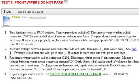

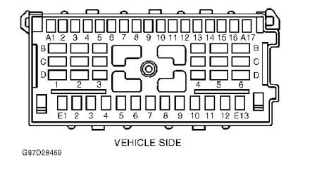

Okay, sorry that did not work out for you. No relay that I could find in my sources for wiper system. However, lets do some tests before we start replacing anything else here.
https://images.2carpros.com/forum/automotive_pictures/261618_test_1.jpg
FIGURE 1

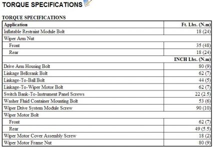

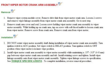

I have also found that the crank arm seems to be a common issue on the 2000 Silhouette, so if the tests for the wiper switch are all good, we may need to test crank arm. Crank arm removal procedures are below.
https://images.2carpros.com/forum/automotive_pictures/261618_Noname_135.jpg
https://images.2carpros.com/forum/automotive_pictures/261618_ts_1.jpg
Hope this helps.. Thanks for using 2carpros.com!

Is the C201 connector visable or hidden behind something?
To add a little more confusion to the issue I now have this scenario. Now when you turn them off. The passenger side wiper goes to the park position. And the driver’s side goes to the lower part of the windshield trying to go to the park position but stops about 3 inches short of the park position. They don’t stop in the extreme out position when you turn them off now. But do try to park. Thanks,
John

Sorry about that. Connector C201 is located at the bottom left side of the steering column. It should be black in color and should be a 48 Pin connector, as pictured in previous post.
Electrical issues are sometimes weird like that so you are better off testing the wiring before replacing anything else. This will help save some green, which is what we all like to do :D

Having owned one of these for the last 8 years I have had the wiper parking up problem several times. I had never removed the cam from the motor so I assume that it was properly aligned. Solution: Remove cover from cam. Spray WD40 or other cleaner/lubricant all over the cam making sure to get in between the plates of the cam. If the plates stick together, the cam will not go into the proper park position. This always worked for me. If you have removed the cam, and have reinstalled it, and they do not park correctly, make sure the cam is seated all the way down, as it must make contact with the bracket tab that is referred to in the installation instructions. If it is not seated all the way down, it will not hit the tab to engage the cam to park the wipers, it will just pass it, and park the wipers up.
