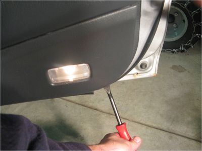

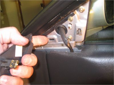

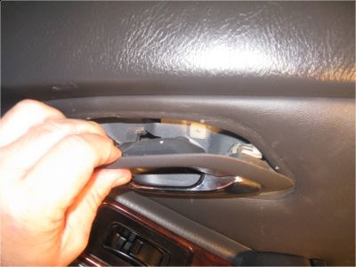

I believe that to replace the side vier mirror, I need to pull off the interior side door panel.
How do I remove the interior side door panel?
I am reluctant to just yank off for fear for breaking whatever is holding it on and not being about to re-install the panel.
Any advice would be appreciate.

Hello Thanks for the info Okay..I am sorry, it looks like the manual doesn't show pics of how to remove the panel..so this is my thought..I am getting ready to pull a panel off of another type vehicle tomorrow. I can take some pics and that will at least give you an idea.......then kind of talk you through the rest and give you what the manual does say do you want to do that? If you do then it won't be until tomorrow late before you get the data Also, do you have automatic windows or roll up manually? Now what I do suggest though is to go to the dealer tomorrow and ask for some door panel clips, the ones that hold the panel to the door. Me..I would get the correct number, they may be about 50 cents each. I call them little Christmas trees .also have them print out the IPB of that so you see where they go it will help get things straight in your mind. When I do this the clips always break - at least one or two depending on how brittle they are then the panel won't stay on.....so....this is having the part there before you tear into it.....you can always take them back. Last you will either need a door panel removal tool (pic below) or if you are really careful you can use a screwdriver or two

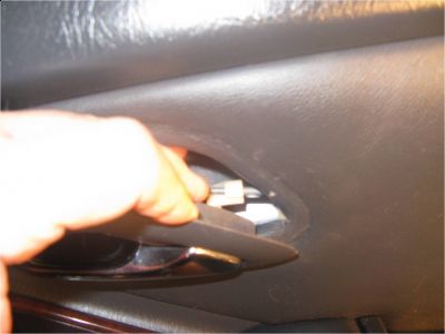

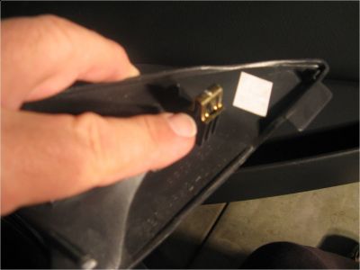

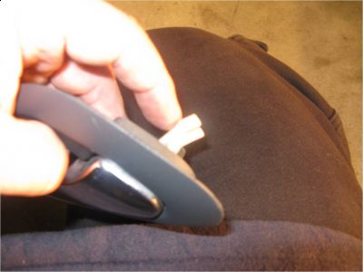

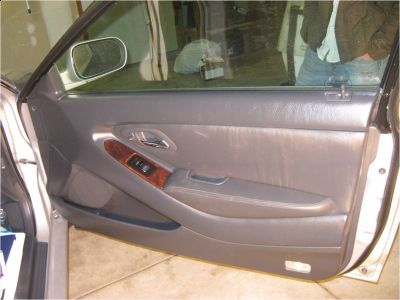

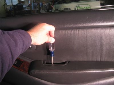

Hello - Okay - here are the pics for the door panel..........There will be differences but hopefully this will give you an idea. The main thing.......go slow and be careful.......things can be sharp. The door panel
https://images.2carpros.com/forum/automotive_pictures/248015_1368_1.jpg

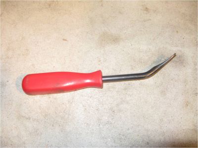

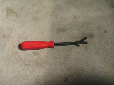

Look the door panel over really good for screws - fasteners, clips that cover screws etc. Here is my door panel tool.
https://images.2carpros.com/forum/automotive_pictures/248015_1369_1.jpg
https://images.2carpros.com/forum/automotive_pictures/248015_1370_1.jpg

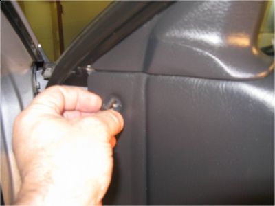

A clip
https://images.2carpros.com/forum/automotive_pictures/248015_1371_1.jpg
https://images.2carpros.com/forum/automotive_pictures/248015_1372_1.jpg

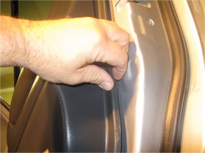

This panel just pops off and has a clip behind it.
https://images.2carpros.com/forum/automotive_pictures/248015_1373_1.jpg
https://images.2carpros.com/forum/automotive_pictures/248015_1374_1.jpg
https://images.2carpros.com/forum/automotive_pictures/248015_1375_1.jpg

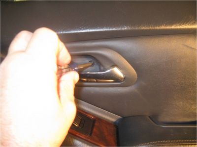

By the door handle has a screw.
https://images.2carpros.com/forum/automotive_pictures/248015_1376_1.jpg
The arm rest area has a screw
https://images.2carpros.com/forum/automotive_pictures/248015_1377_1.jpg

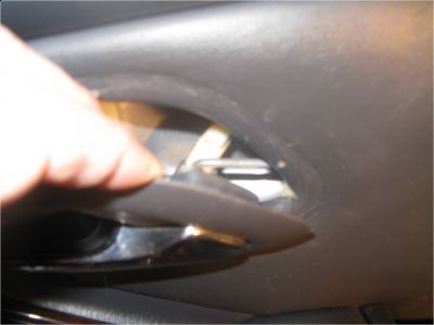

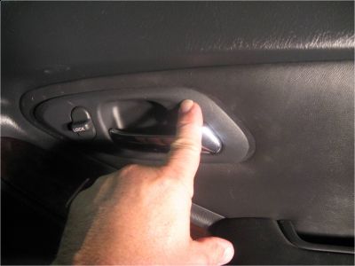

Okay the handle around the door release handle pops forward a little.
https://images.2carpros.com/forum/automotive_pictures/248015_1383_1.jpg
https://images.2carpros.com/forum/automotive_pictures/248015_1384_1.jpg

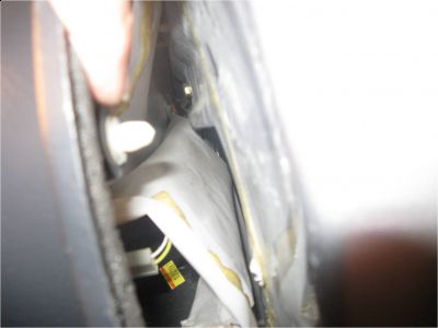

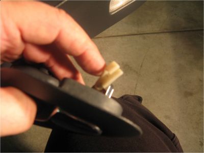

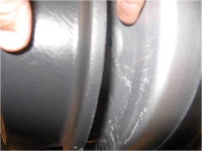

Now there is a clip that holds the door handle rod....it pops off and turns, the rod pops up from it.
https://images.2carpros.com/forum/automotive_pictures/248015_1385_1.jpg
https://images.2carpros.com/forum/automotive_pictures/248015_1386_1.jpg
https://images.2carpros.com/forum/automotive_pictures/248015_1387_1.jpg
https://images.2carpros.com/forum/automotive_pictures/248015_1388_1.jpg

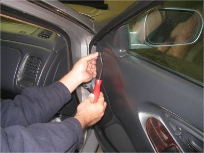

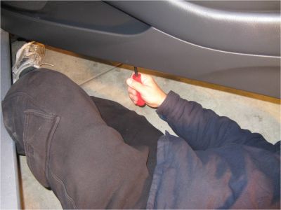

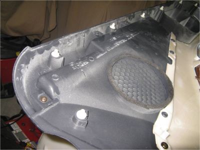

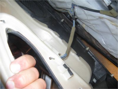

Now the next pics just show the tool and clips or christmas trees.........I start at the bottom and work my way around......put the tool right on the clip and they pop right out.
https://images.2carpros.com/forum/automotive_pictures/248015_1378_1.jpg
https://images.2carpros.com/forum/automotive_pictures/248015_1379_1.jpg
https://images.2carpros.com/forum/automotive_pictures/248015_1380_1.jpg
https://images.2carpros.com/forum/automotive_pictures/248015_1381_1.jpg
https://images.2carpros.com/forum/automotive_pictures/248015_1382_1.jpg

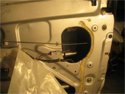

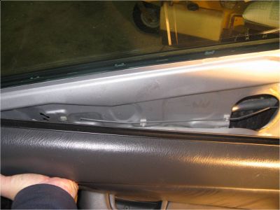

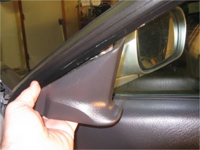

The door panel on this model lifts up - don't forget to disconnect the electrical connectors.
https://images.2carpros.com/forum/automotive_pictures/248015_1389_1.jpg
https://images.2carpros.com/forum/automotive_pictures/248015_1390_1.jpg
https://images.2carpros.com/forum/automotive_pictures/248015_1391_1.jpg
https://images.2carpros.com/forum/automotive_pictures/248015_1392_1.jpg
https://images.2carpros.com/forum/automotive_pictures/248015_1393_1.jpg
Well, I hope this helps!

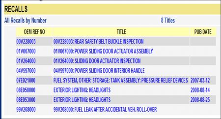

Hello Also, it looks like you may have some recalls on your vehicle. The dealer may fix these for free. Please contact the dealer service department, give them the VIN number of your car and have them check on these to see if they apply to you.
