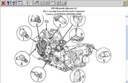

I have 99 silhouettte I need to know the location for torque converter look up switch (control selenoid switch) thanks for any help

The TCC solenoid is at no.8

Hi my question is if the TCC solenoid is located inside of transmission and if the tranny needs to be removed for replaced. thanks for any help

You have to drop the tranny to get at it
