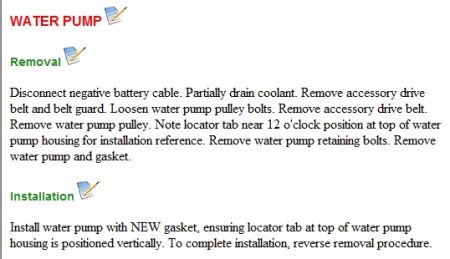

I need some instructions on changing the water pump on my mini van ....

https://images.2carpros.com/forum/automotive_pictures/261618_Noname_2404.jpg
