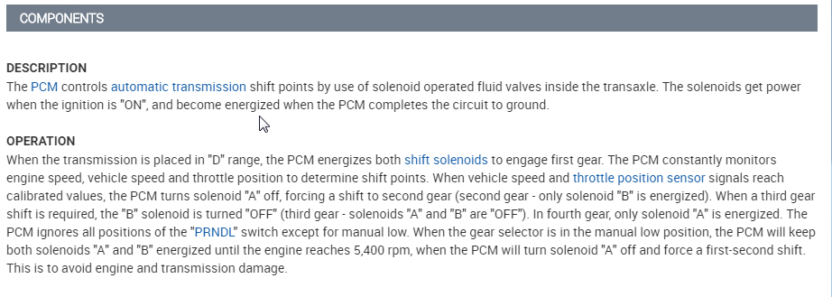

My 95 olds silouhette has overdrive issues. For the first twenty minutes or so of driving it will shift into overdrive and lock out, but after that it goes out of overdrive into drive (from 1,600 rpms to 2600 rpms at 60 mph) had codes read on it. Three of the ones that came up were the throttle position sensor PO123, shift solenoid B PO755, and one was PO740 TCC error. I replaced the thottle position sensor and the first two codes I just mentioned went away but it didn't change anything. It shifts fine up until overdrive, doesn't slip at all, but it's killin' my gas mileage. Any thoughts?

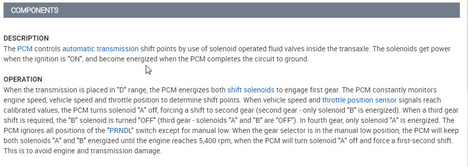

This post was almost 10 years old so I doubt they will respond. However, have you done anything with the shift solenoids? I attached the strategy that the PCM uses and more than likely you have a solenoid issue issue or the throttle position sensor is not reading properly. Read over the attachment and see if any of that makes sense to what your vehicle is doing. If not, we may need to get a new post started with your specific vehicle information.
