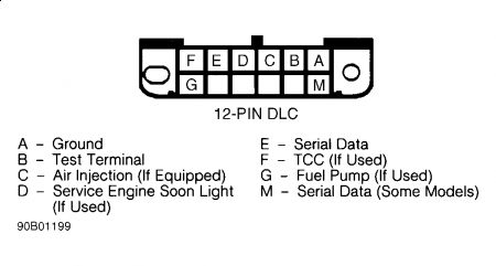

Is there voltage to injectors on pink wire?check PCM for codes see diagram jumper between term. A and B MIL will flash so flash pause flash, flash is 12
https://images.2carpros.com/forum/automotive_pictures/198357_Graphic_204.jpg
if you have 16 pin then need dealer to code.
