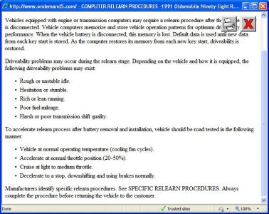

How do I reset the computer

hopefully thats what u were looking for to reset ur computer after a dead battery.
