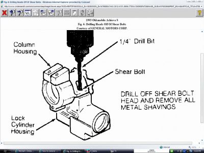

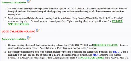

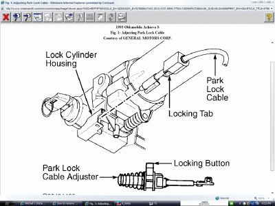

how di i remove my ignition out of my 1993 Oldsmobile achieva? I have done most of it but it will not come out
Nov 9, 2007 at 7:46 AM
MERLIN2021
  • 17,250 POSTS
This is for the cylinder for the lock,key...
https://images.2carpros.com/forum/automotive_pictures/62217_Instuctions_1.jpg
https://images.2carpros.com/forum/automotive_pictures/62217_Lock_1.jpg
https://images.2carpros.com/forum/automotive_pictures/62217_Lock2_1.jpg
Drill the two riveits
