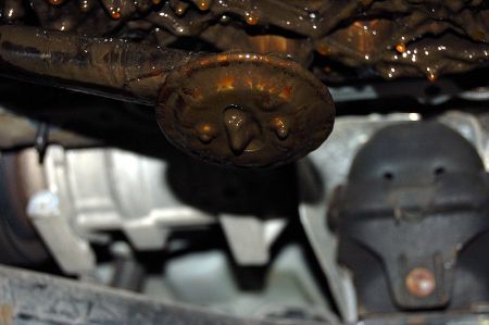

1997 Olds LSS, 6 cy., 142,000 miles. Oil is dirty even just after an oil change. Mechanic said it looked like the oil hadn't been changed in 30,000 miles, but I've always changed it every 3,000 miles since I bought it with 98,000 miles on it. I had the engine flushed about a year ago, but the oil has never been clear. What could cause this, and is there anything I can do about it? thanks

if your tech said it looked like it wasnt changed in 30k, it may be sludge , you bought it with 98k so someone owned it before you and possibly neglected the car i have to be honest here there isnt much you can do , you dont want to use an additive they just kill bearings , and the flushes didnt work , sorry i dont have any good news if you need anything let me know jim thi is what slude looks like from inside
https://images.2carpros.com/forum/automotive_pictures/59481_DSC_04565_2.jpg

WELL , IF YOU HAVE SLUDGE IN THE PAN , IT WILL BE IN EVERY ORIFICE IN THE ENGINE BUT ON THE OTHER HAND IF YOU DONT MIND PAYING FOR THE LABOR , YOU COULD ATLEAT CLEAN THE PAN AND THE PICKUP SCREEN (SHOWN ABOVE IN PIC) AND TAKE A PEEK AT THE LOWER END , LOOK FOR ANY OVERHEAT ON THE ROD AND MAIN CAPS AND THE CRANK ,

Suggested Repair
Treat the dark oil as likely sludge from earlier neglect. Keep regular oil changes, and do not use additives or another engine flush. Dropping the pan to clean it and the pickup screen and inspect the lower end is optional and relatively inexpensive, but it will not remove sludge from the rest of the engine or cure the problem.
