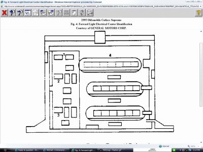

1995 Olds Cutlass Supreme, 4 door
Auto trans
Small V6 engine
I need to change out the directional blinker but I don't know where it is.
Help,
Frank
Friday, October 5th, 2007 AT 11:58 AM
MERLIN2021
MECHANIC
17,250 POSTS
I am comming up with the under hood panel #4position...
It's called the Park/Turn module..
