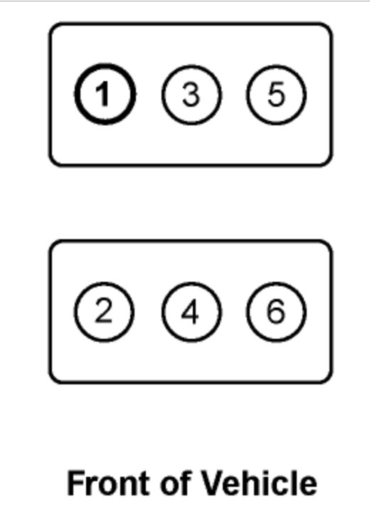

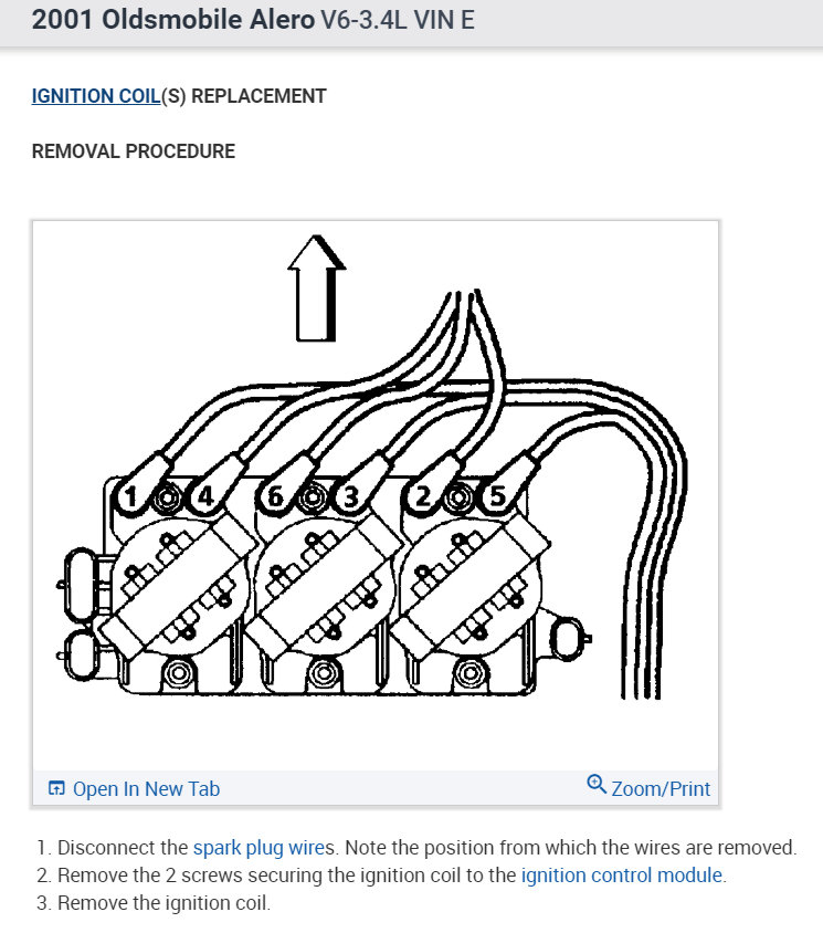

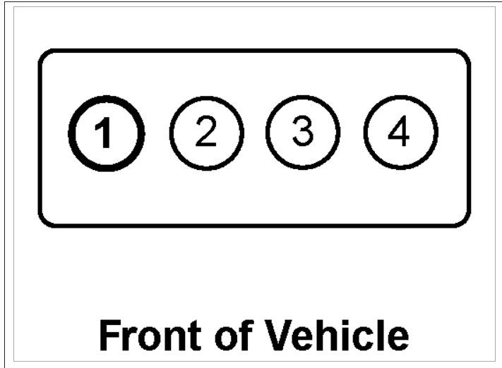

Wires got mixed up when replacing spark plugs on an Alero, 3.4 engine. Need firing order.
Saturday, February 4th, 2006 AT 11:56 PM
9 Replies
GWEATHER1
Here is the firing order for both engines:
Firing Order 1-2-3-4-5-6
Firing Order 1-3-4-2
Cheers

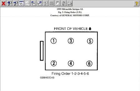

CHUCKWEST1
  • OLDSMOBILE
I need to get the firing order for my 1999 Intrigue, 3.5 L V6 engine. I have only removed the spark plugs from the front coil and the hoses fell to the ground. Now my car hesitates and jerks so I do not think I have them in correctly.
+1
Tuesday, June 19th, 2018 AT 12:26 PM (Merged)
  • 75,992 POSTS
3.5L F/O.
Note: make sure all your connections on the plug wires are tight.
https://www.2carpros.com/forum/automotive_pictures/12900_1999_olds_intrigue_3_1.jpg

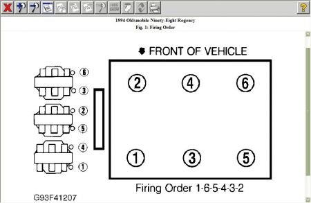

TRESA46952
  • OLDSMOBILE
I have a Cutlass Supreme, 1994, six cylinder, 3.1 engine 100,000 miles. I need to know the firing order of the spark plugs. Thanks, Tresa
-1
LOSONE
  • 1,616 POSTS
1 6 5 4 3 2.
LOSONE
  • 1,616 POSTS
It is not quite that simple perhaps this will help as the firing order changes depending on the set up.
If you have a 3.1L 1994 and older with the coil packs under the front exhaust manifold. Front cylinders are 2-4-6, back cylinders are 1-3-5. Coil packs left to right are 1-4-6-3-2-5. If you have a 3.1L 1995 and newer with the coil packs on top of the engine. Front cylinders are 2-4-6, back cylinders are 1-3-5. Coil packs left to right are 5-2-3-6-4-1
KEN L
  • MASTER CERTIFIED MECHANIC
  • 54,336 POSTS
I found this check out the diagrams below, let me know if you need anything else. Check out the diagrams (below).
