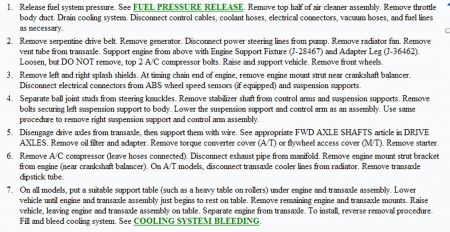

When removing the 3.5 liter engine is it easier to remove from the top or through the bottom and with or without the transmission attached?
May 19, 2008 at 4:04 PM
MERLIN2021
  • 17,250 POSTS
The bottom, and here is the proceedure.
https://images.2carpros.com/forum/automotive_pictures/62217_Engine_Removal_1.jpg
