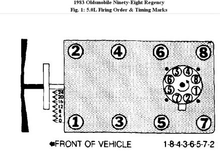

firing order on motor and distributer cap

https://images.2carpros.com/forum/automotive_pictures/30961_olds_2.jpg
