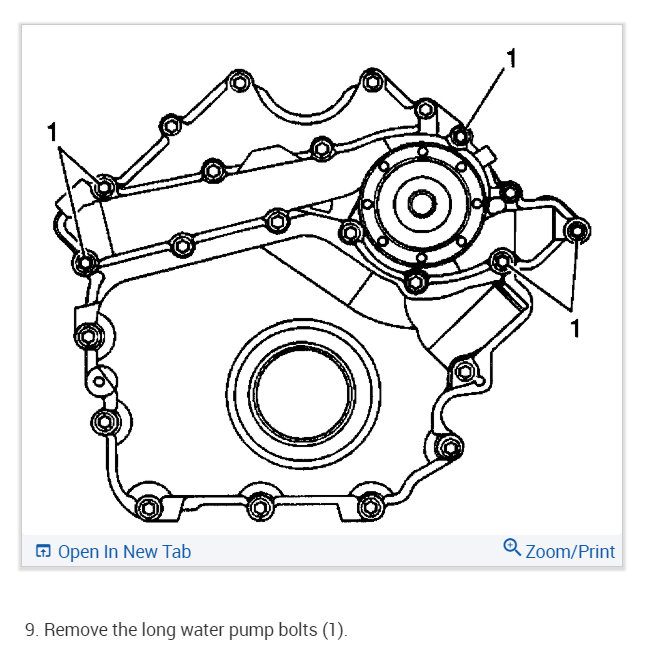

Try jacking up front of car run cap off add coolant as needed to get the air out there is no coolant system bleed. Here is a guide to help you step by step to change the water pump with diagrams below to show you on your car.
https://www.2carpros.com/articles/water-pump-replacement

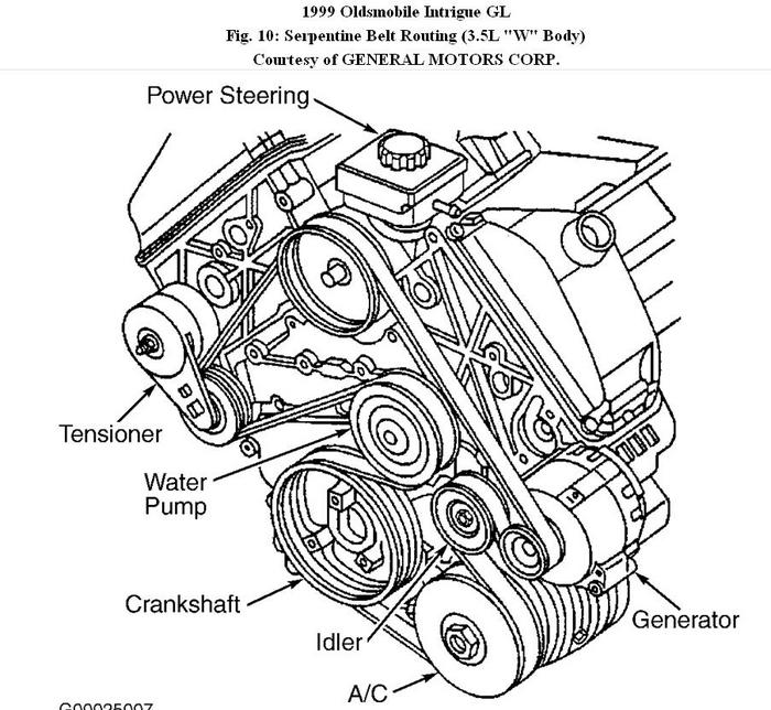

I am trying to change the water pump on 99 olds intrigue. I need to locate the tensioner pulley on the serpentine belt and know how to remove the belt.

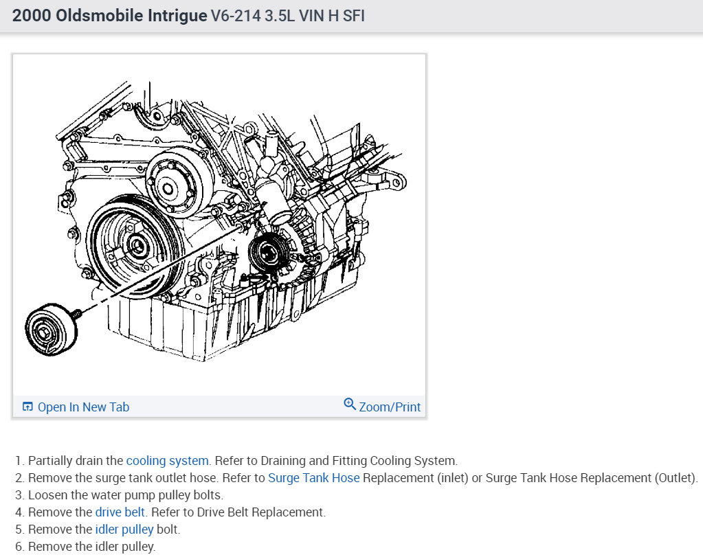

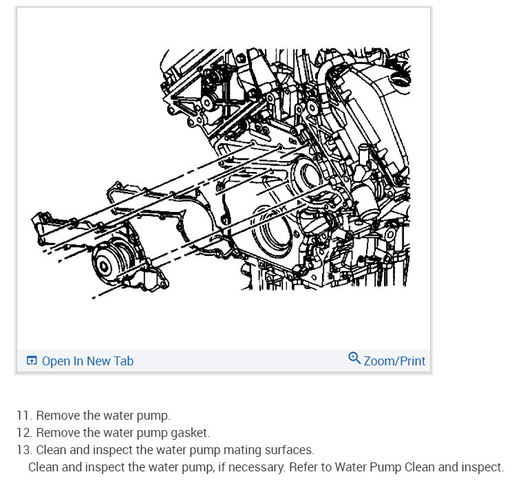

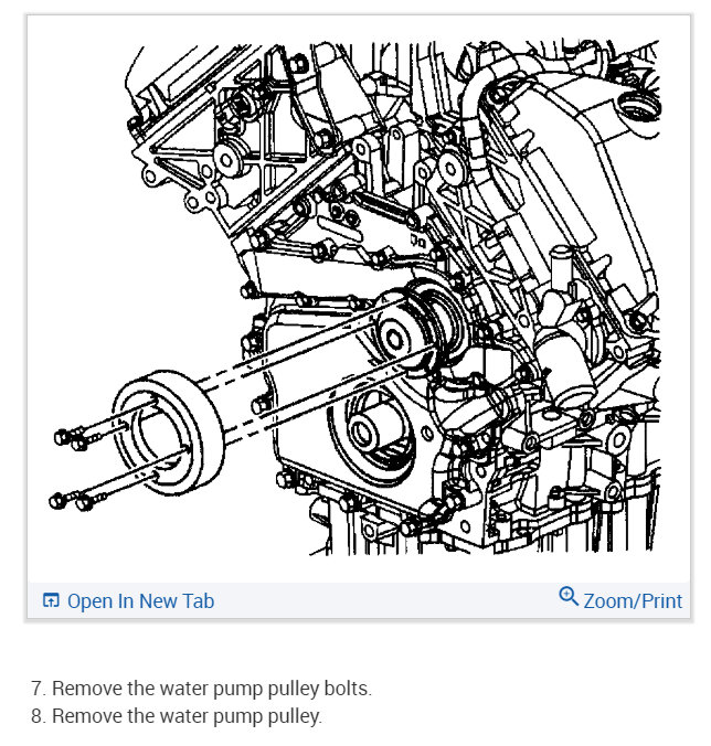

  • 41,812 POSTS
WATER PUMP
Removal & Installation
Remove negative battery cable.
Drain cooling system.
Remove right side front end diagonal brace.
Remove battery hold down retainer and remove battery.
Remove battery tray.
Remove washer reservoir.
Reposition underhood accessory wiring junction block.
Remove accessory drive belt.
Remove power steering pump pulley.
Remove accessory drive belt idler pulley.
Remove drive belt tensioner.
Remove water pump pulley bolts and remove pulley.
Remove water pump bolts.
Remove water pump drive belt shield.
Remove water pump and housing assembly.
To install, reverse removal procedure.
© 2008 Mitchell Repair Information Co., LLC.
At bottom of tensioner bracket you would notice a square slot. Use a socket wrench handle to insert in and turn anticlockwise to loosen the tension on the belt to enable removing it.
