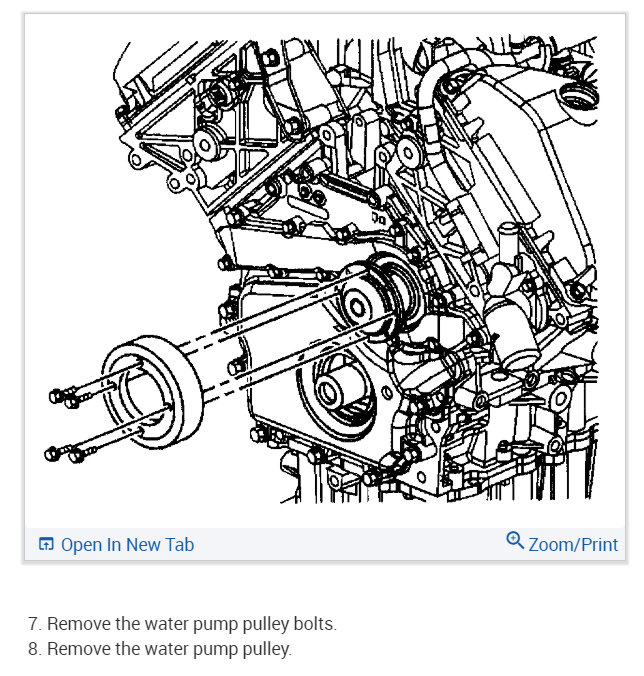

Try jacking up front of car run cap off add coolant as needed to get the air out there is no coolant system bleed. Here is a guide to help you step by step to change the water pump with diagrams below to show you on your car.
https://www.2carpros.com/articles/water-pump-replacement

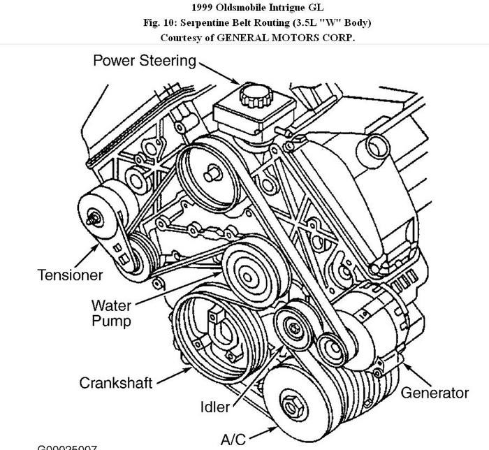

We replaced the water pump because the car was howling. We were told it could be the a/c compressor. I wanted to know if there,s more than one model of intrigue that did'nt offer a/c. we want to bypass the a/c unit with a different serpentine belt are those availible for my 2000 intrigue GL

i think this has the 4.0L in it so there is only one belt routing. it could be the a/c clutch maiing noise or the bearing for that or the clutch has too much clearance in it.

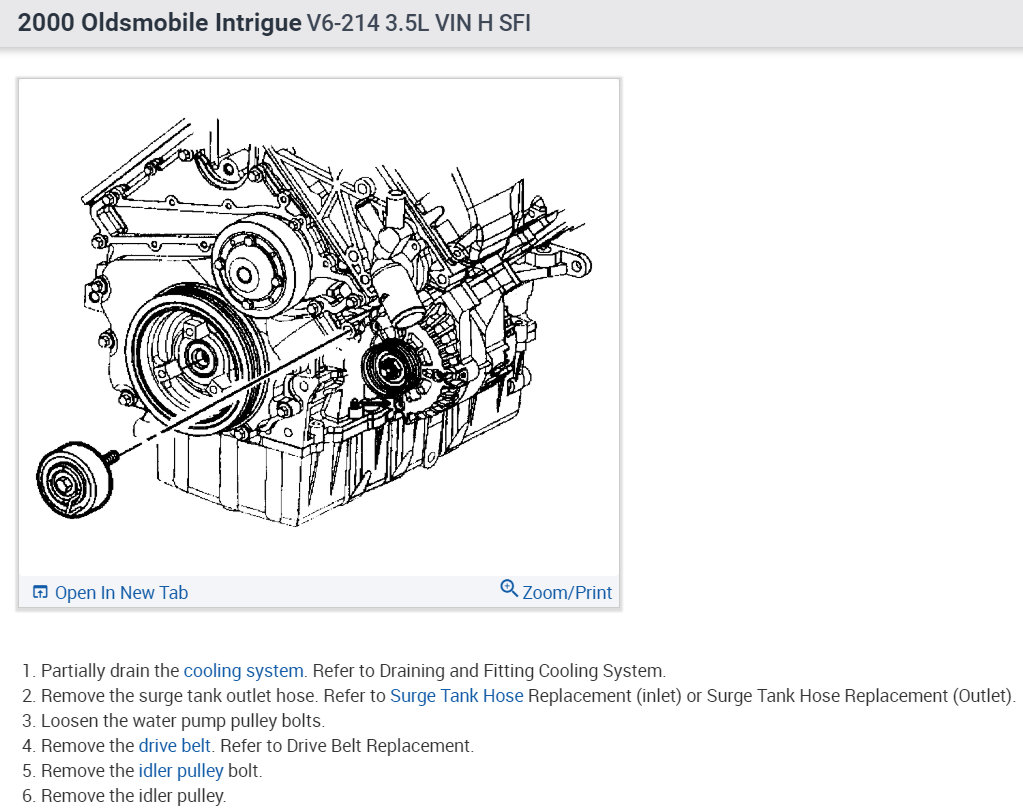

I am trying to change the water pump on 99 olds intrigue. I need to locate the tensioner pulley on the serpentine belt and know how to remove the belt.

Remove water pump pulley bolts and remove pulley.

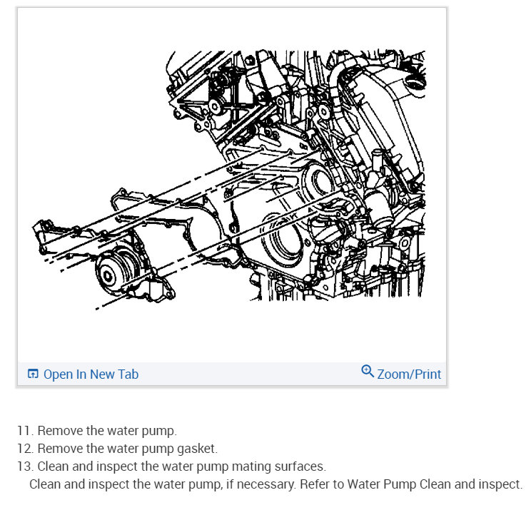

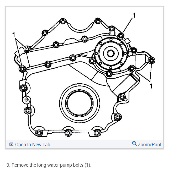

Remove water pump bolts.
Remove water pump drive belt shield.
Remove water pump and housing assembly.
To install, reverse removal procedure.

At bottom of tensioner bracket you would notice a square slot. Use a socket wrench handle to insert in and turn anticlockwise to loosen the tension on the belt to enable removing it.

2000 olds intrigue idler pulley is the bolt a reverse thre
Nov 24, 2018 at 4:06 AM (Merged)
MLEYVA3
is the bolt a reverse thread
MLEYVA3
i have a 2000 olds intrigue am changeing the water pump i have to take the idler pulley off the idler pulley bolt itself is it a reverese thread to lossen bolt ? please anyone can help ?
