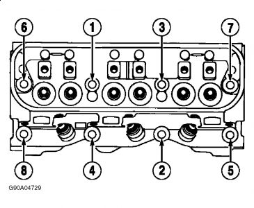

What is the head bolt torque specs?

Step 1- 35 ft. lbs.
Step 2 - additional 130 degs
Step 3 - additional 30 degs 4 center bolts
