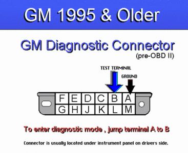

CEL flashing pull the code/s from the computer might lead you somewhere to start
https://images.2carpros.com/forum/automotive_pictures/12900_GM_ALCL_35.jpg

Hello, did you check for codes? You place a jumper between the the A&B terminals of the datalink connector, turn the key on, no crank. The check engine lite starts flashing, you count the flashes to get the codes. Let us know what you find.
