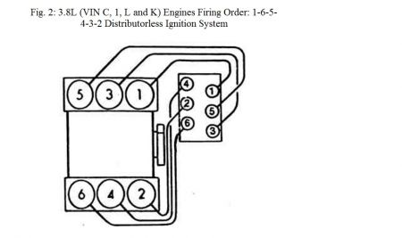

if I pulled all the sparkplug wires at once. How do I put them back in the right order?

You need a wiring diagram that show which one goes where. Repair manuals will have it.

In the diagram, pay attention to the vin. Use the diagram only if your vin is listed.
