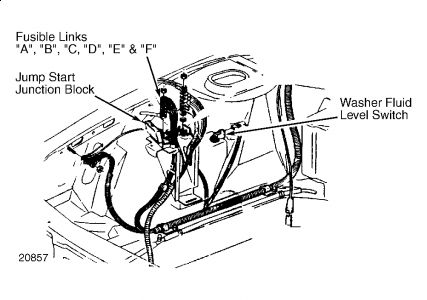

Turn key to start car and nothing. No click, no crank. Have replaced the ignition switch and starter solenoid. Battery voltage @ 12.6V. Took starter off and bench tested and it engages when hooked up to power. Any other ideas? Thanks!

If that check or look good check the Fusable Links... In diagram check Fuse link "A" . I am not sure if they are labeled, so you may need a test light to check either side of link.
https://images.2carpros.com/forum/automotive_pictures/188069_86delta88fuselink_1.jpg

Fusible links checked out okay. Finally got a second pair of hands to assist so I could do some further probing and found that when I turn the key to start I have power up to the neutral safety switch at the yellow wire but nothing coming out of the purple wire that goes to the solenoid. The neutral safety switch is brand new as of 2 days ago. Any ideas?
