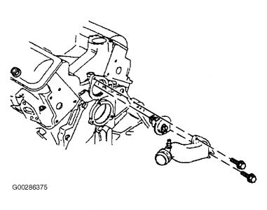

1999 Oldsmobile Cutlass 6 cyl Two Wheel Drive Automatic
YES I WOULD LIKE TO KNOW THE BEST WAY TO GET TO THE THERMASTAT IN ORDER TO REPLACE IT.

3.1L V6 - VIN [M] -1999 Oldsmobile Cutlass Removal 1.Drain the cooling system. 2.Remove the air cleaner. 3.Remove exhaust crossover pipe. 4.Disconnect the surge tank line fitting from the coolant outlet. 5.Remove the thermostat housing to intake manifold bolts. 6.Remove the thermostat housing outlet and thermostat. good luck need manual CHECK IT @ https://www.2carpros.com/kpages/auto_repair_manuals.htm
