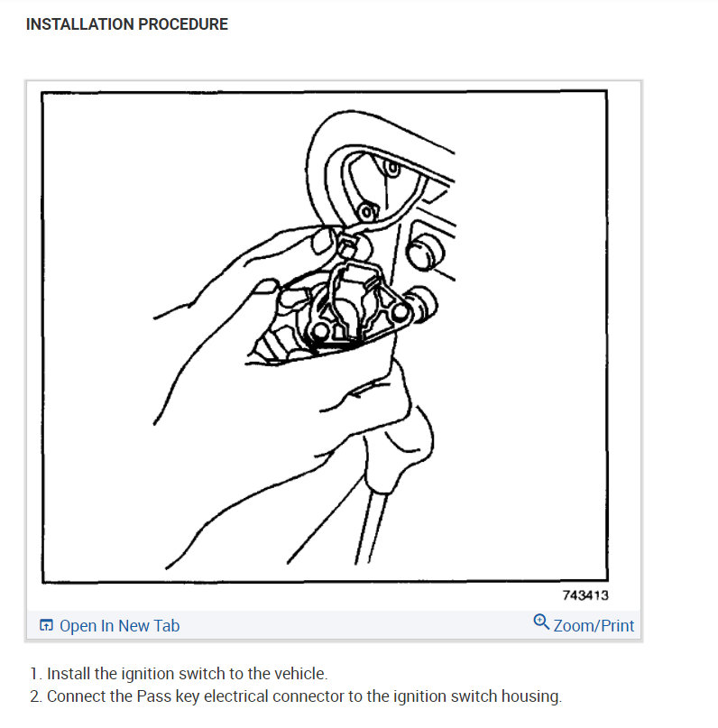

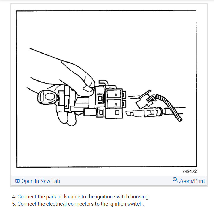

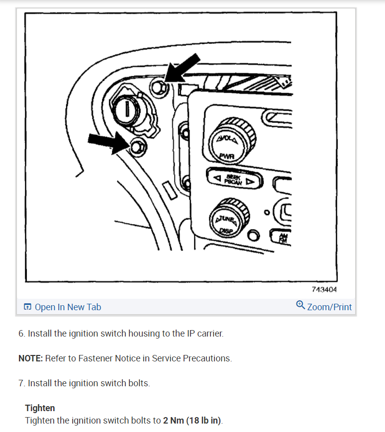

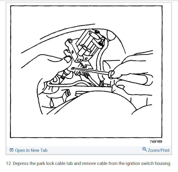

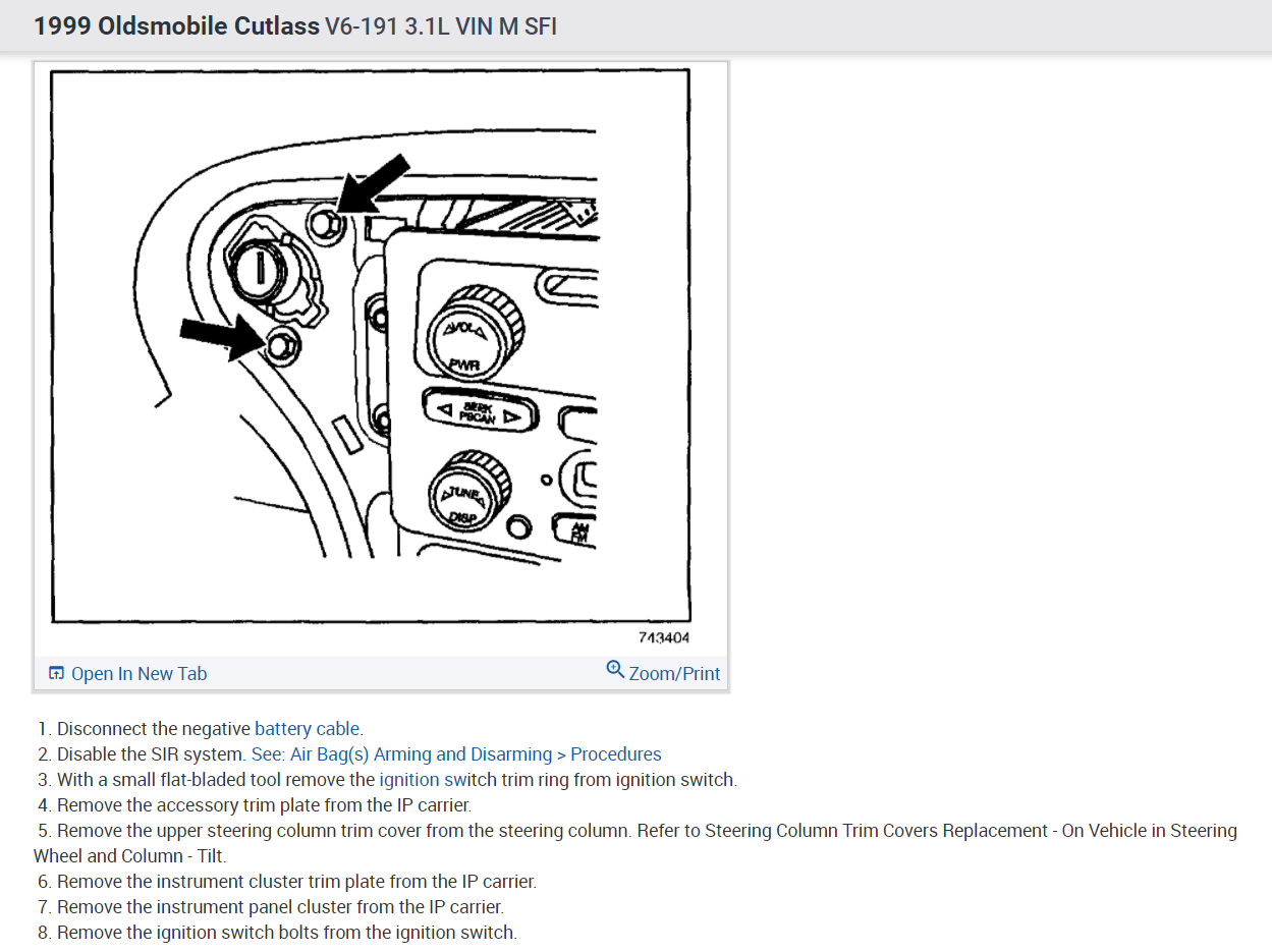

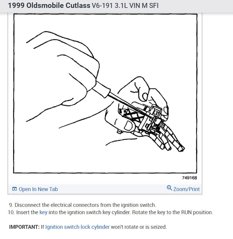

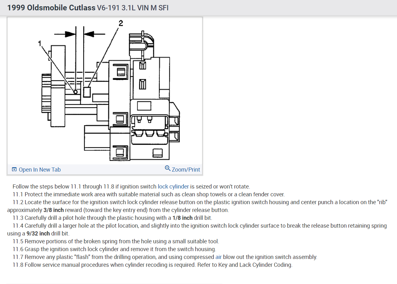

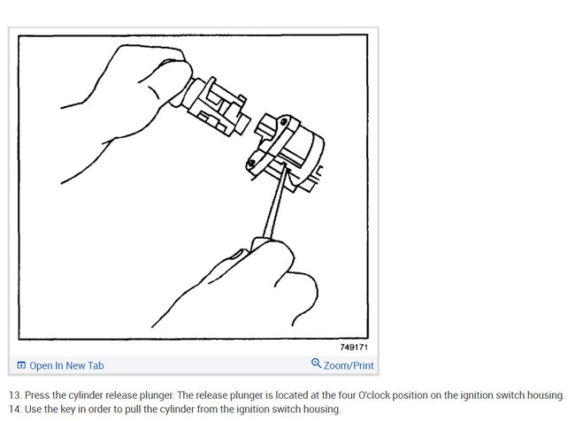

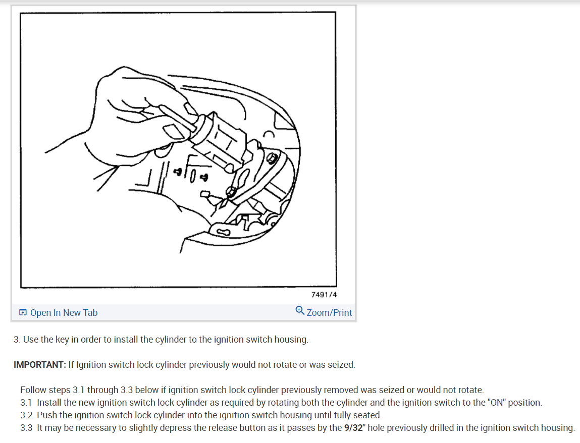

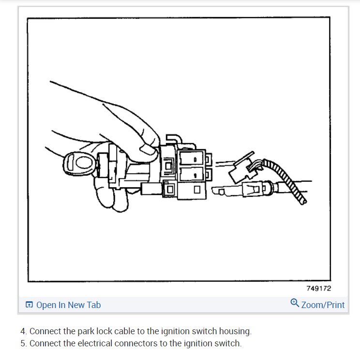

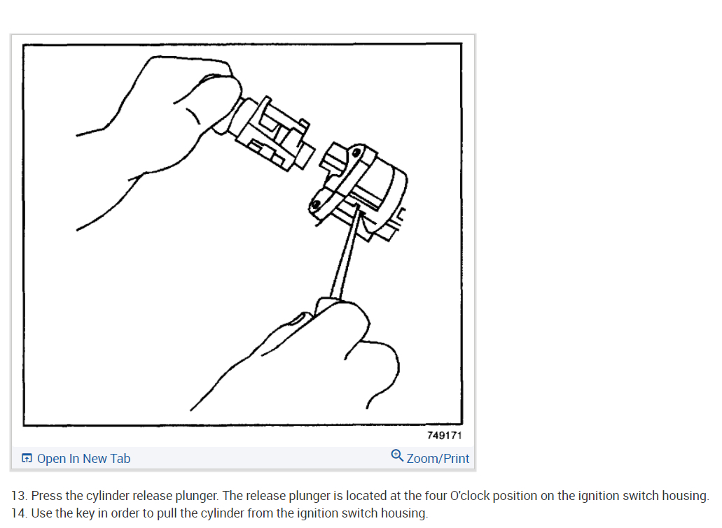

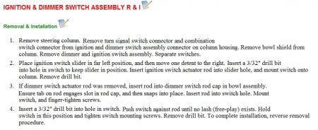

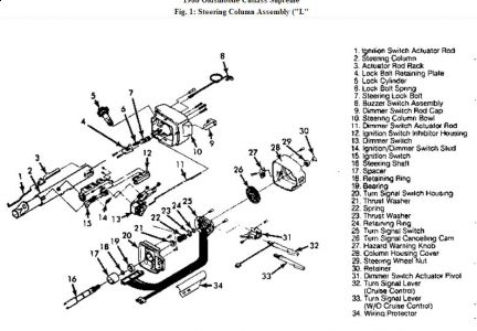

How to remove ignition switch?
Nov 28, 2008 at 1:58 PM
  • 110,240 POSTS
Here are the instructions in the diagrams below to help you change out the ignition switch. Check out the diagrams (Below). Please let us know if you need anything else to get the problem fixed.

JTKNIGHT85
Ignition problem
1995 Oldsmobile Cutlass Supreme 3.1L 6 Cylinder Front Wheel Drive Automatic 167000 miles
The key cylinder has no springing action/resistance. It just flops around and doesn't crank the engine.
I noticed when I look at the side of the steering column facing the door and turn the key I see a little rod move back and forth I'm assuming its part of the ignition switch rack.
Part of that rod is broken, so it doesn't pull on the bottom half that is connected to a cable that runs down the rest of the steering column where I'm assuming its connected to the starter/starter switch.
I have the steering wheel pulled as I originally thought it was the cylinder and key that needed to be replaced.
I don't see how the ignition switch rack really comes apart though.
Was wondering at this point if it would be easier/cheaper for me to try replacing the rack or just unbolt the whole steering column and replace it with one from the junkyard.
My father seems to think replacing the whole steering column is the way to go, but I've already got the column in the car tore down to the ignition switch rack.
Any advice would be greatly appreciated.
Thanks in advance and I'll try to see if I have anything for a donation if the answer reaps benefit.
Sep 19, 2020 at 10:45 AM (Merged)
BLUELIGHTNIN6
  • 16,542 POSTS
to replace the ignition switch assembly the entire steering column has to be removed anyway...so replacing column or replacing just the switch is up to you, either way column is coming out. would you like replacement steps for your steering column?

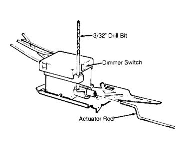

how do i change the ignition switch on my car?
Sep 19, 2020 at 10:46 AM (Merged)
BLUELIGHTNIN6
  • 16,542 POSTS
This is an extremely difficult and lengthy procedure. You must remove the steering column from the vehicle and disassemble major portions of it. Because the column is collapsible in an accident, it is necessary that it be handled with care to avoid distortion of major parts. It must not be dropped, hammered on or even leaned on, or vitally important parts may deform. The procedure for replacing the ignition switch on tilt type columns is not included here because it involves substantial additional work and the use of several expensive special tools. Unless you are rather experienced, we recommend that the job be left to a competent professional mechanic.
1.Disconnect the negative battery cable. Remove the clamp bolt from the steering coupling at the lower end of the steering column shaft (located near the steering box, under the hood).
2.Disconnect the shift linkage from the shift tube lever at the lower end of the column.
3.Remove the steering wheel with a puller, as described above.
4.Remove the left sound insulator and lower column cover.
5.Remove the trim cap or lower trim panel from the instrument panel, depending on equipment.
6.Remove the steering column cover and toe-pan attaching screws. Remove the shift indicator needle from the shift bowl.
7.Securely support the column in position and remove the two nuts attaching the column to the underside of the instrument panel.
8.Lower the column carefully, being careful to retain any spacers that may have been used in order. Disconnect the wiring. Then, carefully remove the column from the inside of the vehicle.
9.Begin disassembling the column, removing the lock plate, canceling cam, and turn signal switch.
10.Remove the ignition lock and key warning switch as described below.
11.Remove the spring and bolt assembly, and the associated thrust washer. Then, remove the rack preload spring, switch rack, and actuator assembly.
12.Remove the upper shift lever spring. Then, remove the gear shift lever bowl.
13.Remove the shift bowl shroud and bowl lower bearing.
14.Unhook and remove the dimmer switch actuating rod. Remove the attaching nut and remove the dimmer switch.
15.Remove the attaching screw and stud and remove the ignition switch, disassembling the actuating rod from the hole in the sliding actuator.
To install:
16.Move the ignition switch sliding actuator all the way to the left (ACC) position. Then, move it two detents (OFF-UNLOCK) position to the right.
17.Then, position the actuating rod hole in the sliding actuator, and install the ignition switch, stud, and mounting screw.
18.Install the dimmer switch with its attaching nut tightened only loosely. Then, depress the switch slightly until you can insert a 3 / 32 in. drill through the hole in the switch housing and slider. Force the switch upward to remove any lash and tighten the mounting screw with the switch in this position.
19.Put the shifter in NEUTRAL and install the shift lever.
20.Install the shift bowl shroud and bowl lower bearing.
21.Install the rack preload spring, switch rack, and actuator assembly. Install the spring and bolt assembly, and the associated thrust washer.
22.Install the ignition lock and key warning switch as described below.
