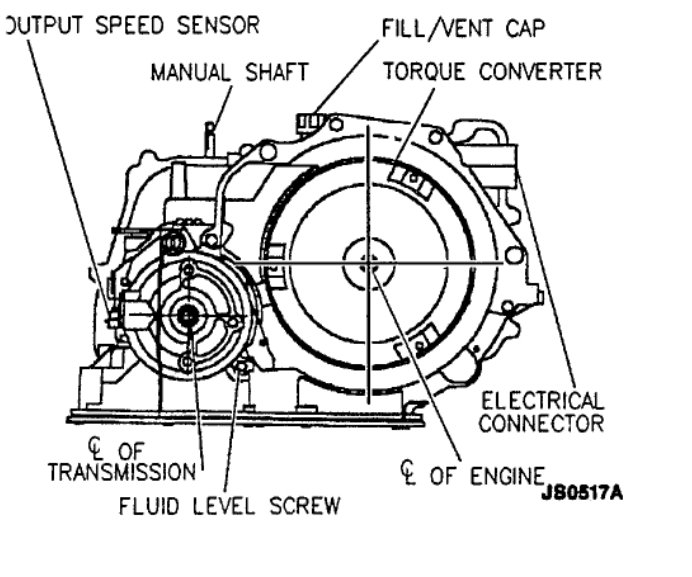

Transmission problem 6 cyl Front Wheel Drive Automatic 117350 miles
My english it's very bad, sorry, I need check transmission fluid level, but i dont have owners manual. Sometimes i try to find the dipstick in the transmission for up side, and under the car, and both sides for the front wheel's, and never find the gauge check or window check.
Anyone help me please?
Mar 12, 2008 at 6:31 AM
  • 55,423 POSTS

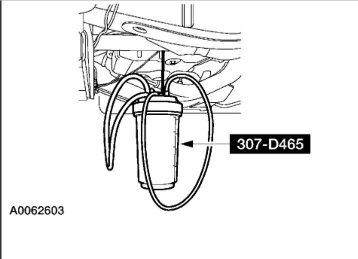

This car has a plug in the side of the transmission case that must be removed to check the fluid much like a typical standard transmission is done only with the engine running. Here is a guide to help you get an idea.
Here are diagrams to help you get the job done on your car.
