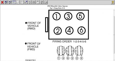

JDL
  • 16,098 POSTS
https://images.2carpros.com/forum/automotive_pictures/170934_31_ciera_1.jpg
My info showed the above for a 3.1 ciera.

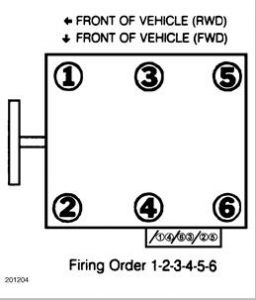

LDOWNER10
1994 Oldsmobile Cutlass 6 cyl Front Wheel Drive Automatic
what is the firing order for 1994 oldsmobile supreme cutlass 3.1 v6
Aug 1, 2020 at 12:21 PM (Merged)
  • 75,992 POSTS
There you go Merry Christmas
https://images.2carpros.com/forum/automotive_pictures/12900_fo_77.jpg

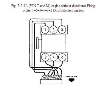

PISTACHIORICAN
I need to know the order of which the spark plug wires are put into the engine.
JDL
  • 16,098 POSTS
Hi, which cutlass do you have? What I looked at was cutlass ciera, 3.1L vin T
https://images.2carpros.com/forum/automotive_pictures/170934_ciera_firing_order_1.jpg

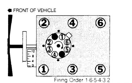

MIKE STEEL
need firing order for 1985 olds. cutlass v6. please send firing order for distributor cap.
  • 54,840 POSTS
Hey Mike, Here is the firing order and distributor rotation diagram you requested for a v6 Gm. Let us know if you need anything else we are here to help.
https://images.2carpros.com/forum/automotive_pictures/561653_firing_order_85_38_1.jpg

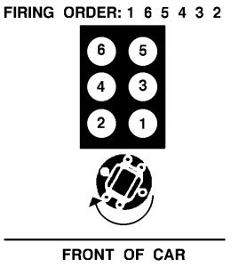

THIZZLLE
i know the firing order for my car its 1,6,5,4,3,2 but i need a picture or something cause i dont know where these are like what wires is #1,6,5,4,3,2 and where is #1 wire is it the one on the left closest to the bumper or closest to the windsheild i dont know?
i replaced my distributor cap and i thought i put wires on in the right order but theres a clicking sound from it and my friend said i put the wires on wrong thats why i need to know which wire goes where
BMRFIXIT
  • 19,053 POSTS
best i can do hope that help
https://images.2carpros.com/forum/automotive_pictures/99387_olds_2.jpg
