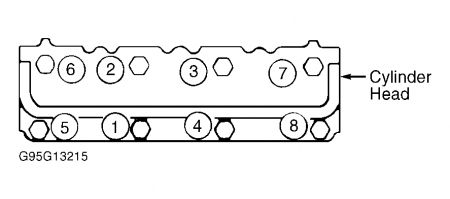

What are the torque settings for head bolts on a 1995 Olds Cutlass Supreme 3.1 Ltr?

Start at 33 Ft. Lbs. and then another 90 ° turn. Here is the torque sequence:
https://images.2carpros.com/forum/automotive_pictures/249084_torque_1.jpg
Let me know if you have other questions. Joe
