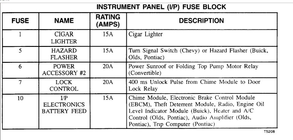

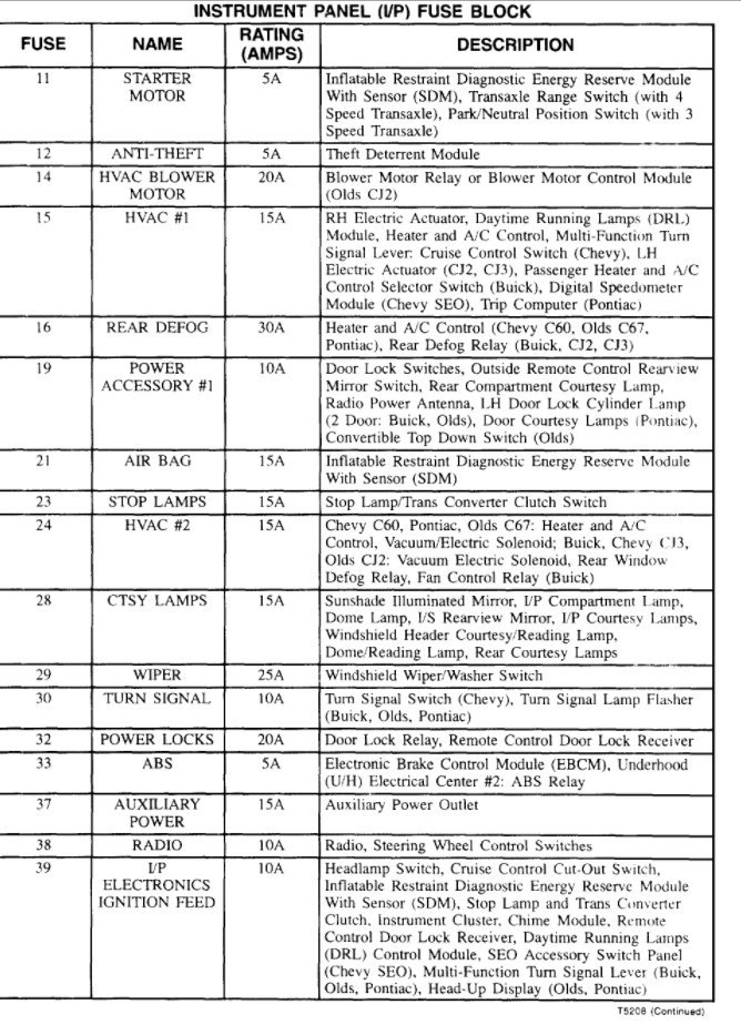

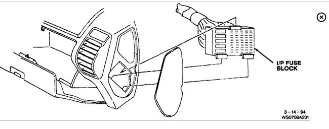

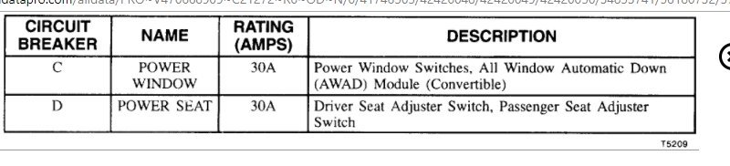

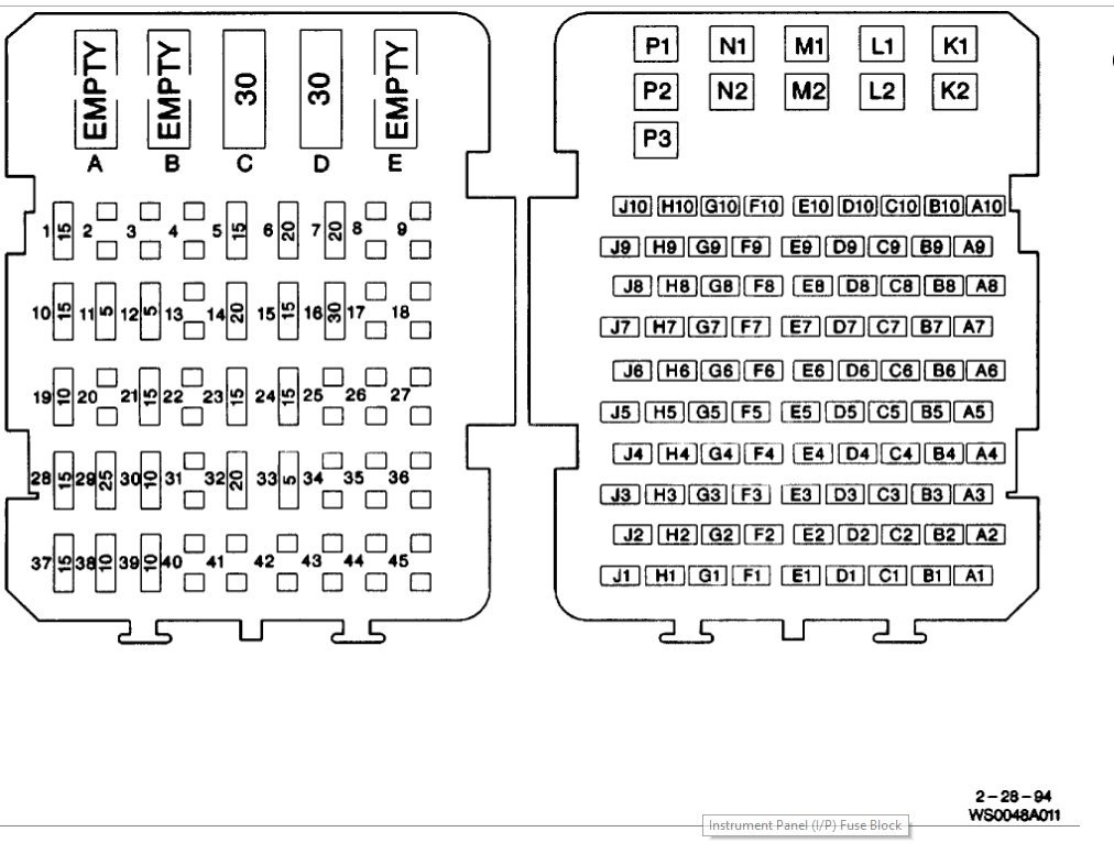

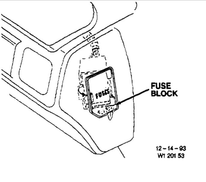

I have found some diagrams (below) that show the fuse box location which is on the passengers side dash panel and the identification for each fuse so you can get the problem fixed. Here is a guide that will help you as well.

Thanks so much for posting this info. I have diff problems, my rear running lights are not working at night, my dashboard lights are off and horn doesnt work at all. These diagrams are very helpful tho and I now know where i can start with the Running lights issue. Hope its not the switch itself, headlights,turn signals and brake lights work, just not the running lights. May have to ask about the horn later tho. Thanks again tho, good place to start!
