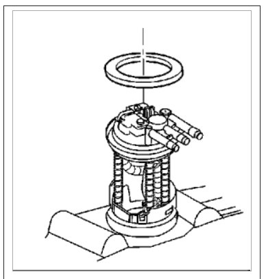

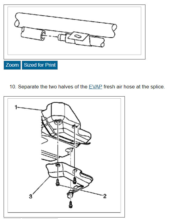

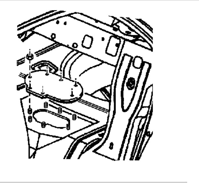

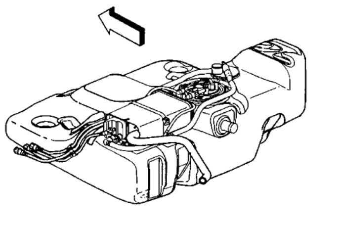

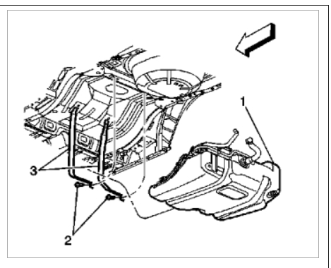

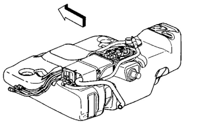

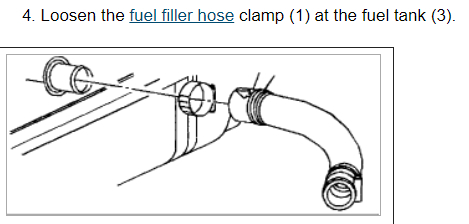

This sounds like the fuel pump is weak and needs to be replaced.
Here is a guide to help you see what you are in for when doing the job.
https://www.2carpros.com/articles/how-to-replace-an-electric-fuel-pump

Thanks so much for your time! Yes it has spark. When the engine dies I can keep it running if I wanted to with injector cleaner. So I replaced the pump and it works great thanks for the guides.
