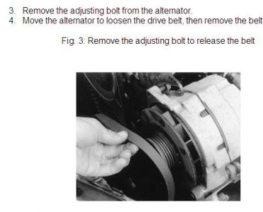

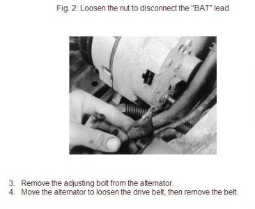

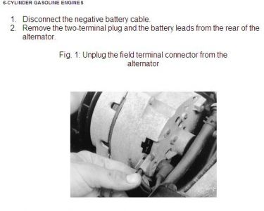

How do you change the alternator in a 1995 oldsmobile cutlas ciera?

Welcome to the forum, the info I looked at was for a 3.1 L engine.
