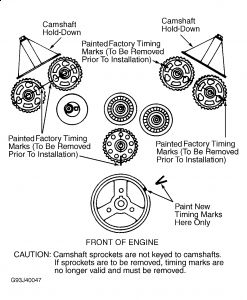

im replacing the timing belt in my 1994 cutlass supreme SL 3.4L. Where can i find the timing gear alignment marks? or how do i align it proplerly if there are no marks?

https://images.2carpros.com/forum/automotive_pictures/261618_Graphic_327.jpg
