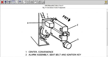

Where do I find the flasher unit in the 1994 cutlass ciera

Behind the glove box in convenience center
https://images.2carpros.com/forum/automotive_pictures/12900_flasher_31.jpg
