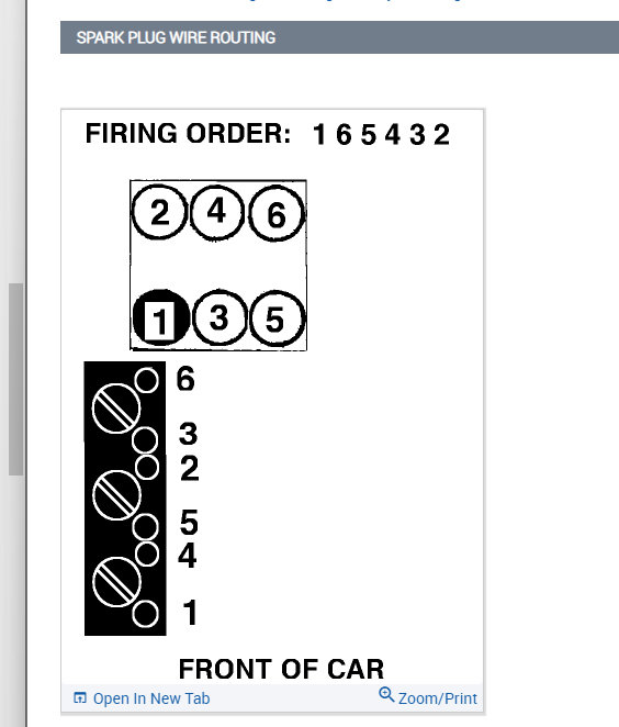

How do I put the new sparks plugs and wire in to my culass supreme 1993 v6

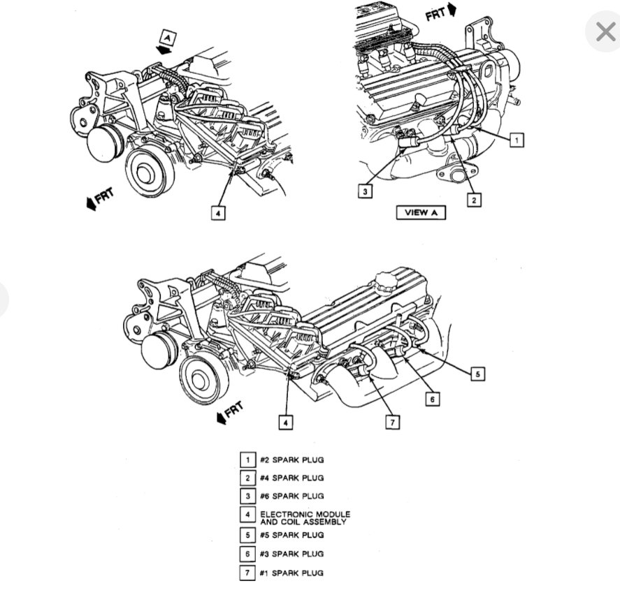

The process is not overly complicated but we need to go one by one. I would not suggest taking them all off and then trying to put the new wires on. I would do one cylinder at a time and that will ensure you get them back in the same position.

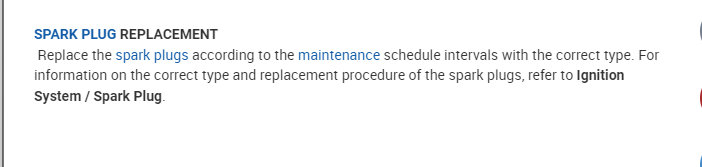

I also included the info below from the manual that will help as well.
Please run through this and let me know what you find or if you have questions.
