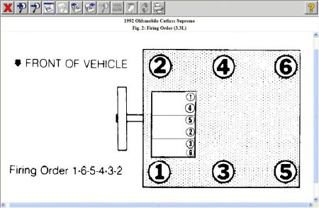

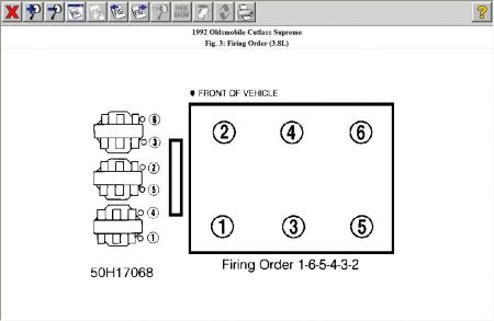

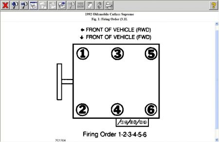

I need to know how the ignition coils are numbered so that I can figure out if 1 and 4 goes at the top or bottom because my car won't start and I replaced the old coils with the new ones. Thanks
May 20, 2008 at 1:07 PM
  • 75,992 POSTS
Here you go Sir, see below
https://images.2carpros.com/forum/automotive_pictures/12900_olds1_1.jpg
https://images.2carpros.com/forum/automotive_pictures/12900_olds2_1.jpg
https://images.2carpros.com/forum/automotive_pictures/12900_olds3_1.jpg
Good Luck
