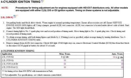

How do you time a 2.3L Oldsmobile engine with dual cams?

It is a Cutlass Ciera; no distributor. Thanks.

looks like the timing its not adjustable on your car anyhow I`m including a picture of the page:
What kind of problem your car has?
