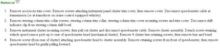

I have 1990 Olds Cutlass Sierra SL and my speedometer quit working. I need to find either a cable or sensor. Can you tell me which one it has (cable or sensor) and where is it located?

That would have a cable.
https://images.2carpros.com/forum/automotive_pictures/30961_olcu_1.jpg
