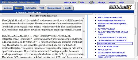

Check and test the crankshaft positioning sensor.
Monday, March 9th, 2009 AT 2:39 AM
SHAFFER017
Ok what will I be looking for what should it test to and were is it located on 3.1L v6
Monday, March 9th, 2009 AT 2:50 AM
  • 75,992 POSTS
The CPS is on the right front of engine
https://www.2carpros.com/forum/automotive_pictures/12900_cps1_7.jpg
