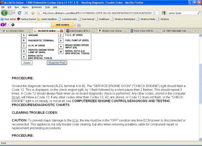

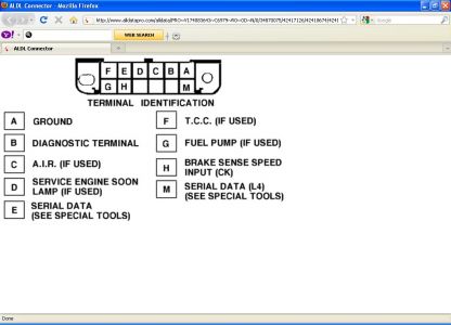

https://www.2carpros.com/forum/automotive_pictures/416332_1989_olds_cutlass_code_retrival_part1_1.jpg
https://www.2carpros.com/forum/automotive_pictures/416332_1989_olds_cutlass_code_retrival_part2_1.jpg
I posted how you can check for code's.If you go to auto zone they rent fuel pressure gauge's rent one all you have to do is use the correct adapter screw it on the thread valve that is on the fuel supply line then crank the car for like 5 seconds and see what the pressure is it should hold steady.Let me know what the pressure is.Do you have spark to both coil's? If you do then i wouldn't suspect a bad ignition module.
