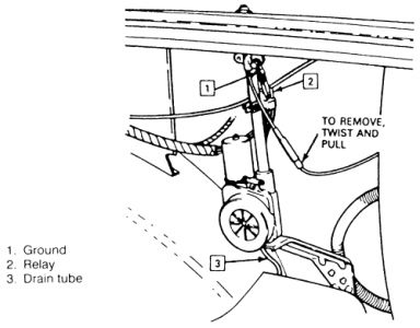

I'm searching on-line for the diagram to install a power antenna in my 1988 Oldsmobile Cutlass Supreme. It's a V8, rear-wheel drive, 305 engine. Thanks very much.

Insert the plastic cable into the housing and stop when about 12 in. (305mm) of resistance if felt. The serrated side of the cable MUST face the antenna motor. Activate the motor to the down position until the plastic cable retracts into the housing. If the cable does NOT retract into the housing, rotate the cable until the cable is pulled into the housing while the motor is operating. Install the contact spring to the antenna. Make sure the flanged end of the contact spring faces upward. Install the antenna nut and cycle the antenna several times to check operation. Remove the luggage compartment side trim panel if the entire antenna assembly has to be replaced.
https://images.2carpros.com/forum/automotive_pictures/261618_0900c15280068458_1.jpg
Let me know if you need the wiring diagram and I will try to hunt that up for you as well.. Thanks for using 2CarPros.com!
