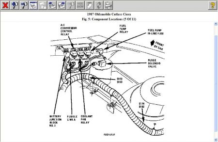

I am totally unable to locate the fuel pump relay in this Cutless Ciera. I have scanned the internet which was a futal effort until I found your site. I have two questions.
1. Where is the fuel pump relay located?
2. What does the fuel pump relay look like?
I will appreciate any help I can get. Thanks Jerry

2.5L 4cyl the fuel pump relay is located right side of firewall on a relay bracket. see below for illustration on relays
https://images.2carpros.com/forum/automotive_pictures/12900_relay_17.jpg
