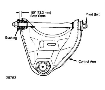

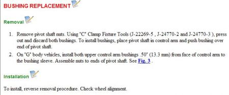

I;d like to know how to replace the arm bushing for an 86 oldsmobile cutlass supreme can anyone help please?

FIG. 3
