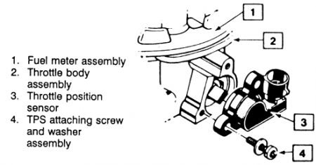

I suspect the throttle position sensor.
The TPS is essentially a variable resistor that changes resistance as the throttle opens. Think of it as the electronic equivalent of a mechanical accelerator pump. By signaling the computer when the throttle opens, the computer can richen up the fuel mixture to maintain the proper air/fuel ratio.
I have 2 tps;
Model 700 TBI assembly or Model 300 TBI assembly?
If you do not know which one you have, let me know so I can give you both diagrams, you can identify which one you have before we can do adjustment.
If adjusting the tps does not solve the problem, I will show you how to perform fuel volume test.

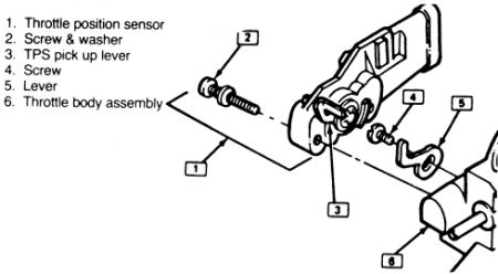

Try to adjust it, only if the sensor has slots on the mounting screws; if it does not have slots, it is not adjustable.
Remove air cleaner. Disconnect the TPS harness from the TPS
Using suitable jumper wires, connect a digital voltmeter from the TPS connector center terminal B to the outside terminal A
With the ignition ON and the engine stopped, The TPS voltage should be less than 1.25 volts.
If the reading on the TPS is not within the specified range, rotate the TPS until 0.42-0.54 volts are obtained. If this specified voltage cannot be obtained, replace the TPS.
If TPS is good, next step will be the fuel pump.
Check the tps first and tell me what happens so we can continue.
fuel pump is expensive and we want to make sure we doing the right thing.
Here are the 2 different sensors, find which one look similar to yours
Throttle Position Sensor (TPS) on a Model 300 TBI assembly
https://www.2carpros.com/forum/automotive_pictures/46384_0900c152800cc50e_2.jpg
Throttle Position Sensor (TPS) on a Model 700 TBI assembly
https://www.2carpros.com/forum/automotive_pictures/46384_0900c152800cc50f_2.jpg

I just installed the TPS and it didnt help. My car wont start but that happened before I installed the TPS. What should I do?
