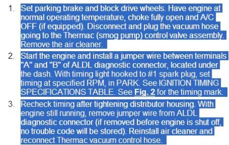

Is there anything in your dash that can cause your car not to fire up i took whole dash off and hasnt replaced it yet?

welcome to the forum, need more info. Are you saying it cranks good but won't start, or it won't even crank?

It turns over but its slow ive replaced disrtibutor starter and alternator and even most recently the tranny was 200 now 350 .

I'd make sure the battery has a full charge, also, if the spark timing is off, the starter may be fighting compression?

fully charged batttery how do you adjust spark timing

You'll have to get a timing lite, are there timng marks and pointer on the harmonic balancer? I tried to post a picture, couldn't get it to work, will try later.
https://images.2carpros.com/forum/automotive_pictures/170934_olds_timing_spec_3.jpg
This is for 5.0 vin Y, automatic, 20 degrees btdc, @1100 rpms.
