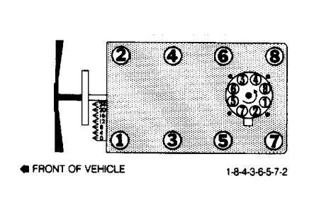

1984 Oldsmobile Cutlass WHAT IS THE FIRING ORDER ON THE SPA
1984 OLDSMOBILE CUTLASS
80,000 MILES • V8 • 2WD • AUTOMATIC
SMOKEY302
I DON'T KNOW WHERE THE WIRES GO ON THE DISTRIBUTOR CAP
Sep 1, 2008 at 10:08 AM
MERLIN2021
  • 17,250 POSTS
This is 5.0 gas...
https://images.2carpros.com/forum/automotive_pictures/62217_fo_2.jpg
