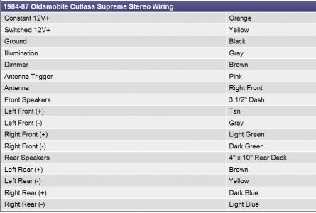

I bought a 1982 cutlass supreme from the Auto Wreckers and it runs PERFECT. Its pretty decent on gas and i have had the dents fixed, and a nice new metallic black paint job put on it. I have had 15 inch p05s put on with black rally rims. It has turned out really nice, i do have some questions though. The radio doesn't work, and its all original interior. My Ipod adapter that you put in the lighter switch doesn't register with the lighter switch (doesn't even charge.) Does anyone know how to make this work without having to get a new dock ( i have a nice new dock for it, but dont have the money to have it switched at the moment. Rear Wheel Drive

You might check the cigar fuse for voltage. My wiring info for your model year is limited. Check radio fuses. The oldest stereo wiring I could find was for 84 supreme, don't know if the same as 82? That wiring info was through the courtesy of the12volt.com
https://images.2carpros.com/forum/automotive_pictures/170934_supreme_stereo_wiring_1.jpg
